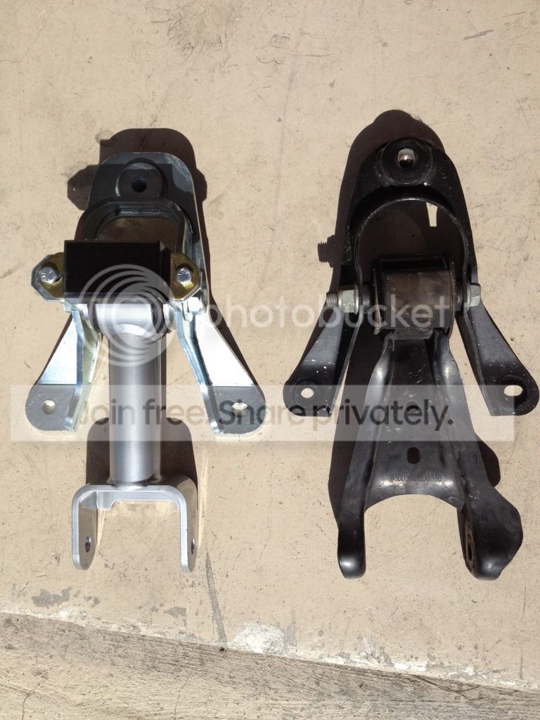

The UCA features the same heavy duty construction as our LCAs, and the HD UCA mount is much stronger than the factory stamped steel piece, so there is no longer flex in this critical area.
Here is a side by side comparison:

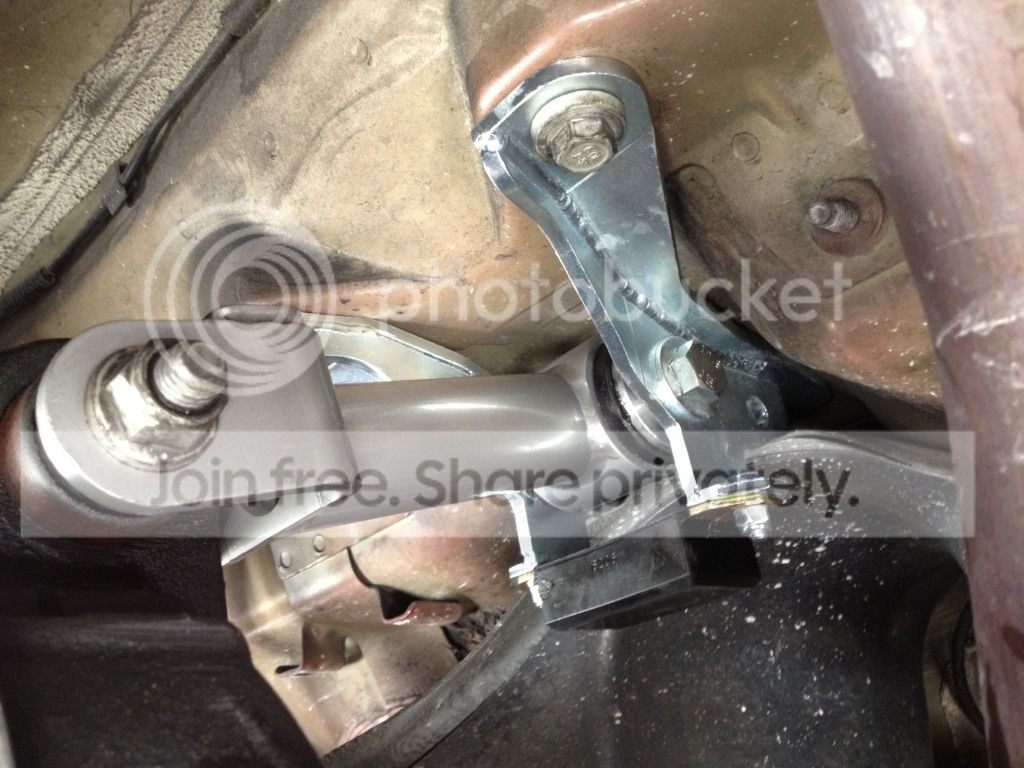

And here are the Pro Street UCA & HD Mount installed. Installation was simple and straightforward, but working space is tight around the UCA.

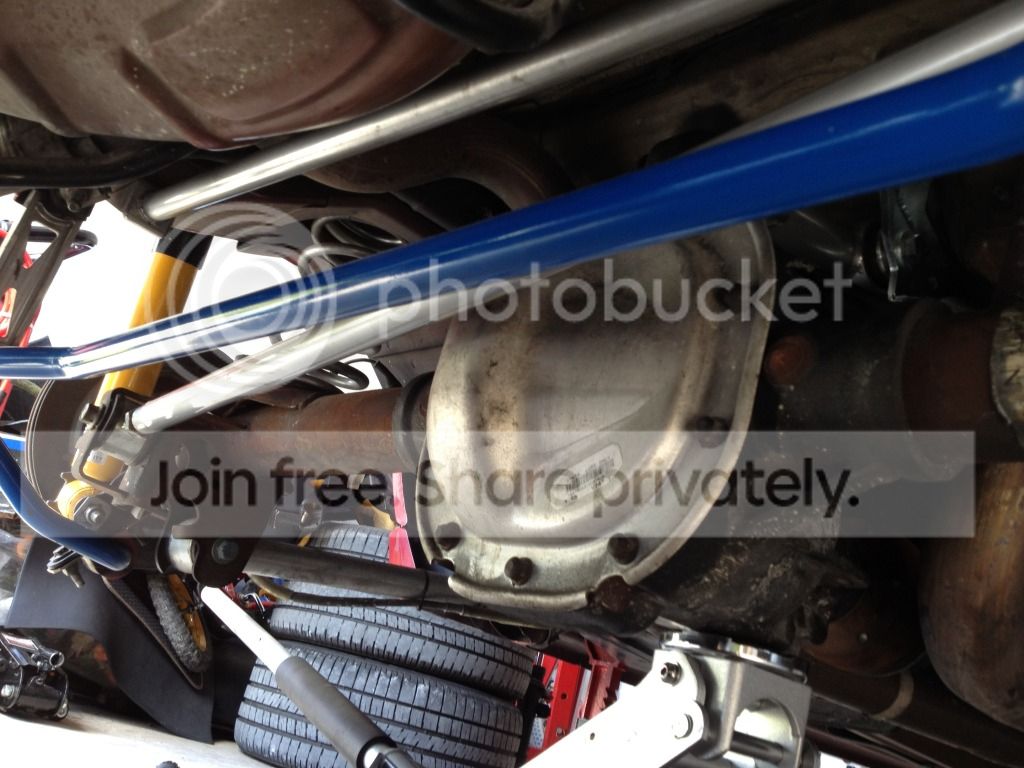

We upgraded the factory panhard bar with our Pro Street chrome-moly double-adjustable panhard bar and we also replaced the factory panhard brace with our chrome-moly brace.
http://www.uprproducts.com/mustang-pro-street-adjustable-pan-hard-bar-05.html
http://www.uprproducts.com/mustang-pan-hard-brace-05.html

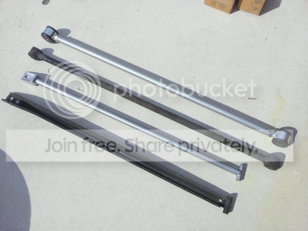

The Pro Street PHB is on-car adjustable and features polyurethane bushings for reasonably quiet operation. Here they are side-by-side:
Installation was very simple with hand tools. Here they are installed:

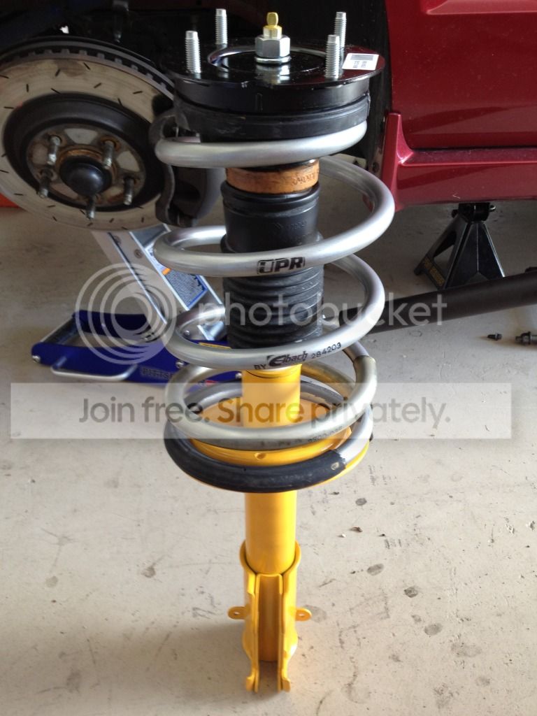

We are still debating which dampeners to offer with our S197 Handling Package. On my car, we used Koni Sport (Yellow) struts and shocks, which work quite well.
The shocks and springs were an easy install. Here's a closer look:
Moving onto the front end, we installed the previously mentioned Koni Sport struts and UPR/Eibach Pro Series springs with FRPP's M-18183-C GT500 strut mounts, which we carry at UPR. Here is a shot of the strut/spring/mount package prior to installation:

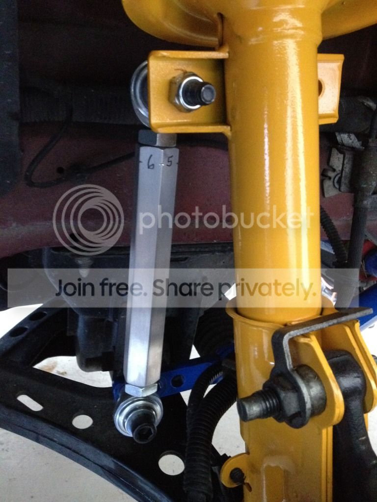

With the strut assemblies installed, we upgraded the occasionally problematic OEM swaybar end links with UPR's billet swaybar end links.
http://www.uprproducts.com/mustang-billet-sway-bar-end-links-front-05-satin.html

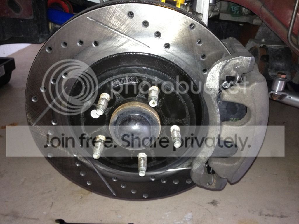

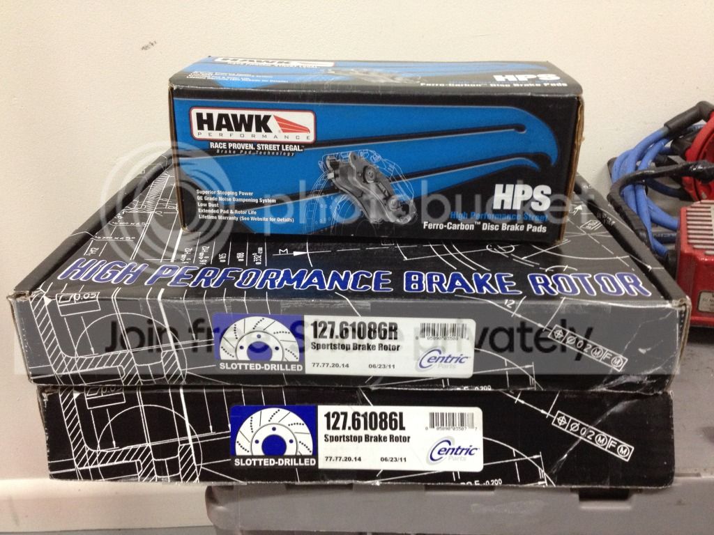

While we were up front, we installed these Centric brake rotors and Hawk HPS pads. (the rear was previously upgraded to HPS pads during the Sebring test and the whole system uses Motul RBF600 brake fluid)
Much better:

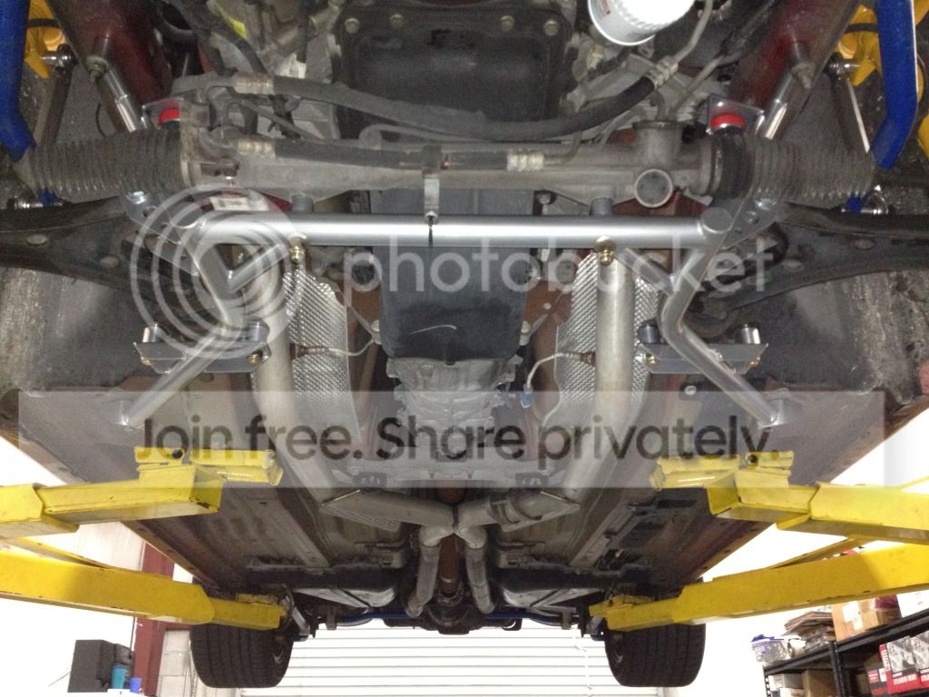

Last but most certainly NOT least, we installed our UPR tubular chrome-moly k-member kit to drop some weight off the nose and lower the engine 1/2" for a lower center of gravity.
http://www.uprproducts.com/mustang-pro-series-chrome-moly-k-member-05.html
We took the car to Mustang Performance Racing in Boynton Beach, FL where Tim Eichhorn made quick work of the k-member install. It can be installed on jackstands with hand tools, but we wanted to photograph the car up in the air, so this did the trick.
