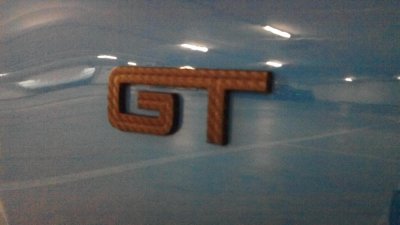

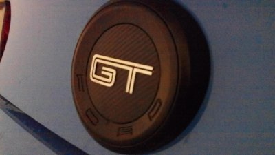

Did the GT emblems in CF wrap and the faux gas cap center in CF. Sorry about the shitty pictures, my camera sucks.
