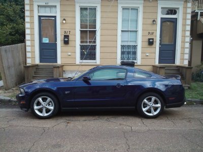

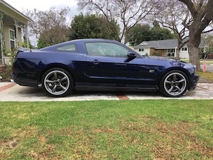

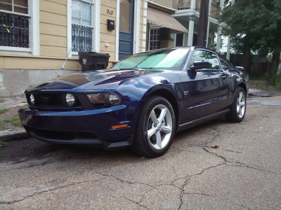

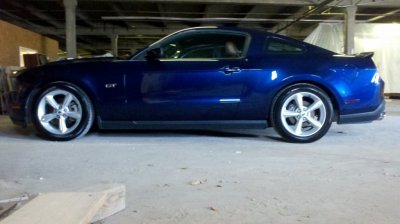

I went with FRPP progressive rate springs (1.5" drop front and rear) and Koni orange all around. Dramatically improved ride from stock, including killing a harsh clunk I had at full rebound in front suspension. Got the entire setup for less than $500. Installed myself in an afternoon. Here are a few photos of stance with stock 18's (before and after) and later 19's.
Just gotta say I dig those rims in the last couple photos!
