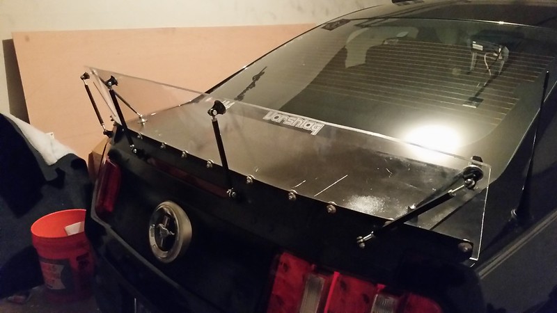

Getting there...need a couple more struts and I'll be downforce ready...
Vorshlag-Fair
Official Site Vendor
Official Vendor
Nov 12, 2010
1,592
107
Dallas, TX
Mark has a nice spoiler now, even if he shoots with a potato-camera... :clap:

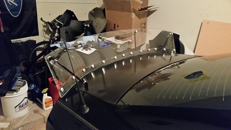

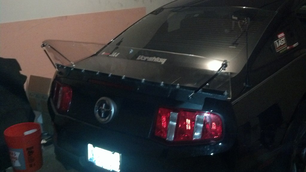

That was version 1, raw aluminum and with 4 spoiler struts supporting the 10" tall Lexan element.
Version 2 with the aluminum bracket painted black looked better. He got the trunk from us also, which made the install easier.
After we noticed some end deflection we went with 2 additional forward facing struts, for version 3. That's what Mark has. We had stolen a few of the spoiler struts for another customer's car but I just got 3 more inbound for him which he will get this week.
I'm excited to see where this car ends up in ESP! As fast as we have seen S197s in ESP we know this car can be a winner. I think it needs BIG tires to win the class (and flares), but that's just me... :idea:
