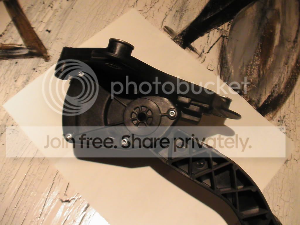

Hey, I took the pedal assy apart and if you're putting that tape into that shaft it's good for few days... put it INSIDE, under the right side cover (not the electrical connector side) and it'll last. Open up the mech-side cover and you'll see what I mean. Fuk, I should had my camera with me earlier today...
Miika I took your pic from MF:

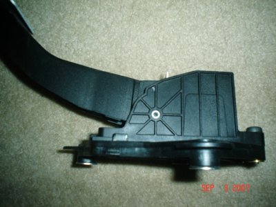

Here's my pedal from my '05, built December '04:
Interesting to say the least. I'll be doing the tape method myself, but the way MikeVisaBlue06 did his.
mvon919
Everwaken
Aug 15, 2007
70
Your pic is from the oher side, but still your is different. In my pedal there's covers on both sides with 5 torx screws keeping it closed.

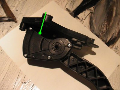

I took mine apart, and drilled a small hole and threaded a 1.25" bolt through it so it would act as a set screw. I am talking about the very back part of the pedal that mounts to the firewall. This is where I put the screw--the head of the screw will be pointing at your foot for the correct orientation.
I put a small piece of metal tube over the outside of the bolt, cut a slot in the end of the bolt so a screwdriver would fit in it. Then I reassembled everthing, and with the gas pedal still hanging from the wiring harness connector, I started the car and tightened the set screw until I saw/heard the rpm starting to increase. I then shut the car off, re-attached the gas pedal, turned the key to the on position without starting it, and then I pressed the gas pedal slowly all the way to the floor, and then let it rapidly release back to the idle position. Started the car and no more lag. It has been running this way for 6 months without any issues.
I don't have pictures of it, but I took one of the pictures above and gave an idea how the set screw would go (in green). In the picture, the head of the screw would actually be behind the plastic part that is shown.
Hope this helps.
Mike

Mike thanks for posting that pic! I had the pedal on and off 3 times tonight. I took the mechanical side cover off and had about the same idea you did on the screw. Seeing what you did makes perfect sense now and is a huge help! I currently have three slices of emblem tape on the pedal arm and only cut the slack about 1/2 way. The tape has too much cushion. I'll need to get in there again tomorrow and do the screw and settle this once and far all.
