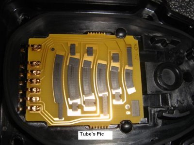

I did some more experimentation on my 06 explorer that also has DBW with the same assembly as the Mustang, but with no lag.
If you hold the pedal down a quarter inch or so, and start the engine, it will not rev up, or affect the idle.
The ECU is constantly calibrating the throttle I'm assuming, so it takes the resistance at start up to be the 0 point on the throttle, and anything more than that becomes + throttle, and if the resistance goes negative at all (lets say you held the throttle down slightly and started the car) it simply re calibrates to a new 0 point.

As with the bunch of folks over at MF and also here, I was really excited about Tube's accelerator mod and I wanted to see it for myself. I have an '05 GT manual with a build date of May 2005. The mods are simple bolt-ons, C&L CAI, GT500 TB, JBA shorties, and Brenspeed tune and I do not a have a "dead pedal" issue. I measured at 1/8" and 1/4" depression and I'm getting revs. However, I still wanted to see if I was one of the lucky ones where the connector brush tines lined up at the edge of the gold/carbon resistor area. So I tried it this afternoon
To my surprise, I have a Rev 4 pedal and not a Rev 1. Attached is a picture of the Rev 4 and also Tube's picture as well. In comparison, Tube's pic shows the brush tines moving across from the gold/resistor area to the plain resistor. As I understood it, the tines moving along this gold/resistor area is the reason for the "dead pedal" effect because the resistivity of the gold/resistor area does not change. Only when the tines move along the plain resistor that the change in resistivity is registered as pedal movement. Now if you take a look at the Rev 4 pedal assembly, the wear patterns of the tines are all along areas that are uniform and have no edges or transitions. I could not see any wear patterns on the plain gold pads.( I apologize for the bad picture). I think Ford tried to fix this issue with Rev 4. The wear patterns stop at a very noticeable distance away from the gold pad edges. I don't think the tines are suppose to even make contact with the gold pads. If you zoom in, you can see some faint patterns getting close to the gold pads on the side where it's marked "PVI england" but I don't know if it was me removing the cover and making the scratch. For these reasons, I did not perform the mod and re-assembled the pedal.
Over at MF, when adidasUNT8 tried this, he had some problems and he had a Rev 4 assembly. I think what happened was he bent the tines to the point where they ended up touching the bare gold pads and this may not be a good thing but I'm not 100% certain because I don't understand the electronics and calibration went enough.
Bottom line: I believe Tube's modification will help those with the tolerance and variation issue in the Rev 1 assembly. However, I'm not so sure that this mod will be as beneficial (it may be even harmful) for those with the Rev 4 assembly. I would love it if someone finds a way and then I can retract this statement and implement the mod.
