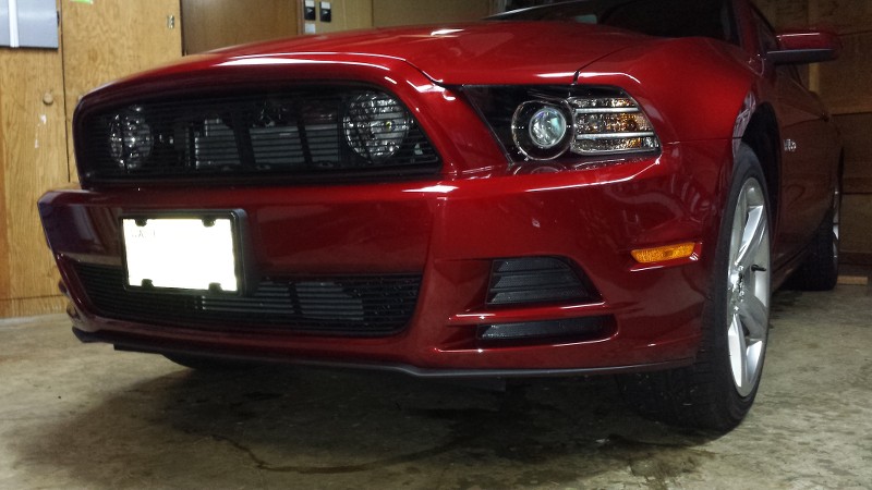

Looks like the Cervinis grills finally shipped. I hope the quality makes up for their total lack in customer communication skills I have experienced thus far... Clients should not have to call in to see why an order has not shipped weeks after payment was taken...

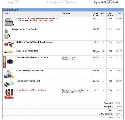

Well... Ordered me some basic cleaning supplies to begin the process of taking care of "Pepper"...

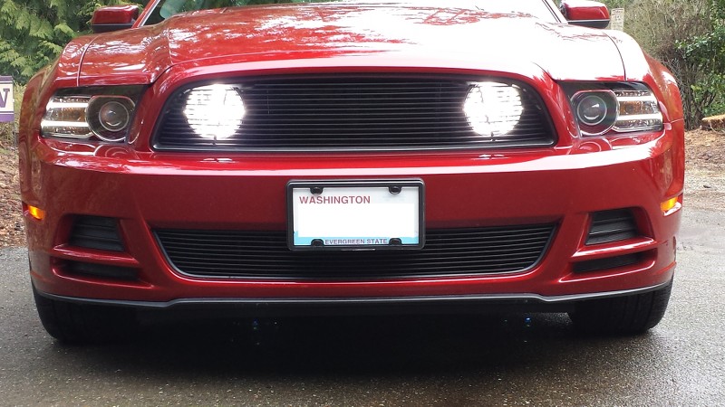

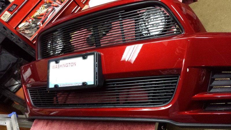

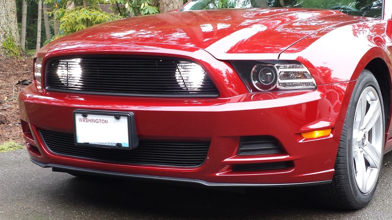

Cervinis Black Powdercoated Upper and Lower Grills 2013-2014 S197
OK... I must be honest and start off by saying I am not entirely enthusiastic about this set. Here is why...
  1. I Had to call Cervinis to learn that their site was in fact wrong. They do not have Five of these kits in stock at all. Their timer and inventory count was frankly, false. I called seven days into my looking everyday for a tracking number. Only to learn they had these on back order. Really! Is it to much to ask that you email or call us. I mean after-all, you took my $$ immediately.
  2. I emailed asking questions about one week before making my purchase. Until I made my purchase I never once heard from them. Their loss as I decided to not buy the Stalker kit. I figure if they will not respond to me in a reasonable amount of time (Not counting weekends of course) they must not need my business. Then, once they responded... It was like they only read the first sentence and responded. I had to email them back asking for answers to the other questions.
  3. The way they packaged these grills is mediocre at best. Both units had slight bends (1/4" at the farthest point) at the top of one and at the bottom on the other, creating the need for me to need to bend them back in place. UPS did a wonder to one of the boxes (Completely crushed). However, my point is this... By the time the two boxes got to me, the grills had been flopping around inside the box like an item that had no box filler. The single "Clumped" packing paper they used at each end was no longer doing anything. I am rather shocked more damage had not happened to be honest. It was really that bad! I will however give them credit for how they protected the surface of the product with tightly wound bubble wrap and plastic wrap. Might be the saving grace of the the poor packaging to be honest...
  4. The Powdercoat they used is pretty thin. Now I have had a few items powedercoated. Including some rims for my SUV and ugly factory grey parts on my CanAm Spyder we wanted to make matt black. And I am here to tell you, these grills will need to be re-coated in a few years just from the road spray and washing's it will go through. It is VERY thin and I can scrape it with my fingernail... I know most powdercoats are thin. But at least I can say with my other parts they will likely outlast the paint on the vehicles. Not a chance with these grills. Poor quality or not enough heat...
  5. The installation for the top grill is pretty straight foreword. However I would rather they provided a template for us for the drilling needed. No big deal, just would have been a welcomed thought because their instructions are written for those that have done this before to other mustangs. I had to search the web for other 2013-2014 Mustang Grill changes (Used CJ's they did on the Roush BTW)
  6. The lower grill may just be a personal thing, so take this with a grain of salt or two. The Lower Cervinis Grill is just mounted to the lower grill as it sits from the factory. And the screws they provided... "There is no bloody way they would ever work"... The Honeycomb Ford designed is roughly 1/2" thick. The screws Cervinis provided did not even touch the place they intended the screws to mount at. Did Cervinis even try to install one of these after R&D? Then to top that off. I did NOT like the look of the honeycomb staying in the open area. I would have much rather seen Cervinis design a new grill "Surround" Like the factory upper unit has. Been happy to pay $40-$50 for it. At least then it would match the upper grill once installed! You see... Ford designed the Honeycomb upper grill portion to separate from the grill surround (My guess is because of all the grill options from the factory made this a design requirement). And the lower is one single mold. Not three different pieces (Fog/Outer Surround grill/Center honeycomb grill). So what I did after a little debate was get out my dremel and removed the portion of honeycomb that Ford designed air to flow through. And left the rest as it was.
Now, with that all said. I would not buy this kit again had I known what I know now. The Roush kit is one I would consider instead. That said, I did chose the Cervinis kit because I do not care for the larger gap between each horizontal portion (Bars) of the grill that the Roush kit has. I like the tighter (More horizontal bars) that the Cervinis provides.
I do think my disappointment comes down to just how this went from beginning to the end. I am quite pleased with the look. I do think it is a complement to our GT. And plan to enjoy them for as long as we can. However, after hearing and reading so many folks loving Cervinis, maybe I expected more than I should have from the get go and that is not fair to them. It does make me wonder now if I might be in fact much better off having not purchased their Stalker kit. Who knows what I would have experienced!
Oh, I almost forgot... Cleaning the Fog Lights looks like it will be a challenge and I may remove them, get a lower fog light kit, or change to the Roush kit (Allowing for larger spacing for easier cleaning potentially). Only time will tell as this is my DD and I run the fog lights most of the time...
Pictures for your pleasure...

Sucks man, I know the feeling. Looks good with the fogs hidden!
