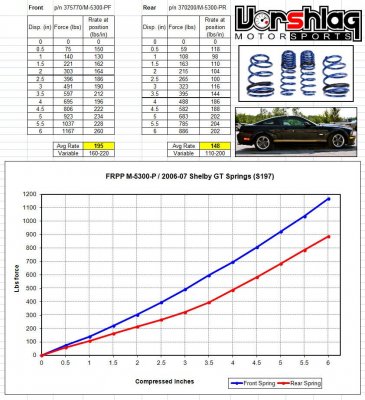

Don't get the spring diagram. The weight on a rear wheel is around 600 lbs? So its compressed 4,5 inch and spring rate is linear, right?

Is this graph etc, just the springs by themselves.... or with mating shocks/dampers ???
That's just the force required to compress the spring a given amount. They put the spring in a press with a weight scale sandwiched in. I think. There was a small write up that accompanied this chart, but I can't find it. I think it was on another forum.
Yes, I believe those springs are linear. As to your other questions, I leave that to the wiser and more experienced. Terry Fair, who produced that spring rate sheet, is super knowledgeable. And also a self professed ass. @Norm Peterson has a good deal of knowledge, based on a lot of track time, and an engineering degree to back it up. He can draw you lots of charts and graphs. And he's seems to be a nice guy. Lot of other guys on here as well that know what they are doing.

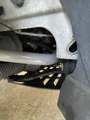

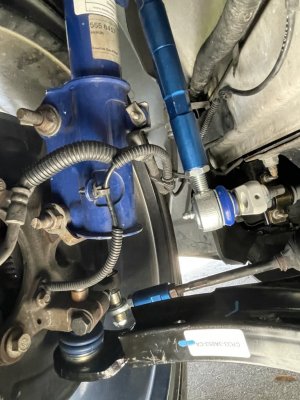

BE6DA336-1521-475B-AC0D-FCE7AAD9755E.jpeg 4E957CA7-14A1-49EC-9314-01C17D87E44B.jpeg 04511403-E2A4-46AC-9E46-91508E480319.jpeg FEEC7A61-6948-4096-A6BA-4972E183235C.jpeg C9104B1F-3234-4BD6-AB21-23C4B7D0C705.jpeg I went with Steeda and couldn’t be happier with it. Got the pro action shocks and struts, sport lowering springs,upper control arm, bumpsteer kit , front lower control arms with X11 extended ball joints , adjustable billet front end links , adjustable front sway bar ( set to the middle hole) , rear sway bar and end links , adjustable panhard bar. Only non Steeda parts were the BMR lcas that were already on the car when I bought it. Probably going to go with the BMR relocation brackets as well. Car is a pretty stiff ride but turns on a dime and just handles. I did put the Ford performance jounce bumper kit on and cut off about an inch on them. This set up is really tight and a lot fun , I love it!
