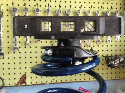

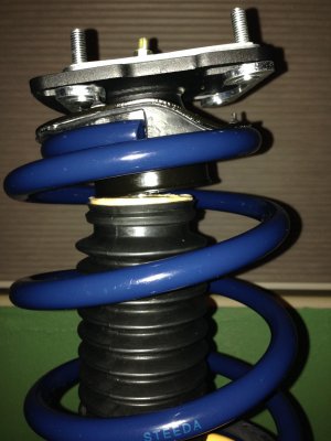

Yeah the issue I'm having isn't with the camber plates, its actually with the springs. the factory spring perches used with the camber plates when inserted into the top coil of the spring causes the camber plates to sit at roughly 20 degree angle relative to the strut shaft installed.
I've spent sometime talking to MM and we've come to the conclusion that the springs I have are wound incorrectly causing the issue, and is the reason for my interest in the MM r&t box components. Figured I couldn't go wrong with matching components in regards to assembly.

Can you post pictures? I know exactly what you are talking about. Our springs are wound just a tad different than oem, but it's very comparable.
I can share pics when I get back in tomorrow of our springs and oem springs, with gt500 mounts sitting on each.

I could actually go far into detail about this topic of spring windings.
Koni perches actually have a different angle than an oem perch.
When we designed our springs, we took that into consideration simply because the Koni dampers are likely the highest volume selling dampers.
So on that note, maybe I just opened up a can of worms and those springs you have may not be the culprit after all. Hmmmm. ;)

Kelly,
For your viewing pleasure. Sorry about the crappy photos ,but let me know what you think.
