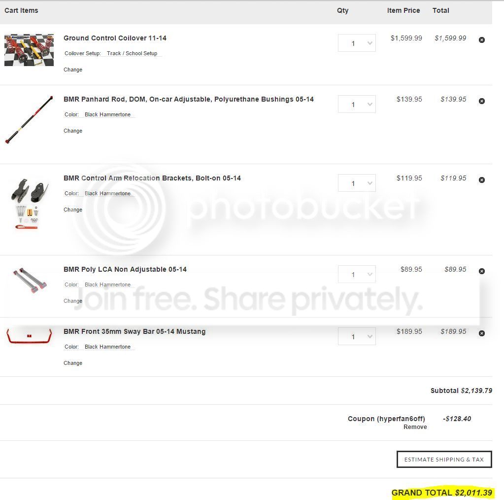

Hello,
I'm wondering what the general consensus is from the S197 community concerning 2011+ Maximum Motorsports suspension parts. From what I can tell they are held in high regards by the earlier Mustang enthusiasts, but there doesn't seem to be much interest for the later models. Their R&T box seems like a solid package at a competitive price point, and I'm very interested.
So to summarize what I've learned in regards to the MM r&t Box, most feel that with its heavy spring rates, and spherical bearings, this kits is to radical for street use.
Although every one agrees MM components are high quality, most feel if building a dedicated track car more advanced components would be used in their suspension builds.
All of which answers my question as to why more s197 owners are not running this package.
I'd like to thank you all for your input, I've learned a lot.
Pretty much. If it were my car...
Or replace the Ground Controls with Vorshlag's Bilstein kit if you want more street-friendly spring rates. Rear bar upgrade is optional IMO.
I would swap out the fixed LCA's for the BMR adjustables with the poly/spherical combo. And an adjustable upper/mount. Otherwise, looks like a good setup to me, nothing too radical since it's a street car.

You can buy KW made ST coilovers for around the price of that Ground Control kit.
CC plates aren't as awesome as thiers, but they are real coil-overs.

I also would certainly go for a spherical panhard and deal with the slight increase in NVH, not a place I would want poly IMO.
Any reason you wouldn't do a Watt's Link over the PHB? Or are we just trying to keep the kit components comparable?

Well, the good news is that the OP already has the Koni's.
If I were him, I would just grab a set of linear springs that are in the 225-260lb/in range up front, and 200+ out back....and grab the other items mentioned in this thread.
If he goes with our components, I can put a package together for him that will make it worth his while and throw him in some of our Elasto Bushings to try out as well.
Everything looks good except for the GC kit, They are a shit ass company that has no quality control and they stand behind nothing.
