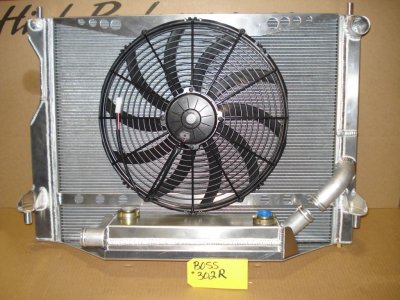

I was looking at the mishimotto oil cooler but now my fluidyne rad started to leak. I asked them what a boss R would use and they sent me this pic. This looks like the rad I saw in the stevenson camaro racecar at the contential race this past weekend. Not familar with oil coolers but what is that bottom tank? Thoughts?
There can only be one possibility since its connected to the radiator...some kind of reservoir for the radiator.
Update:
Oh there are two fittings on that reservoir, so its some kind of cooler. I would guess an engine oil or transmission cooler; I would say engine oil cooler.

Yup its an oil cooler. Manufacturer says its has an additional 18 rows from there GT/boss model to compensate for oil heating.
I guess I could run a thermostactic switch and run lines to this tank. Not sure what gains it would have over the boss cooler.

Weird that they're using a water/oil cooler. I big air/oil coolers were preferred.
