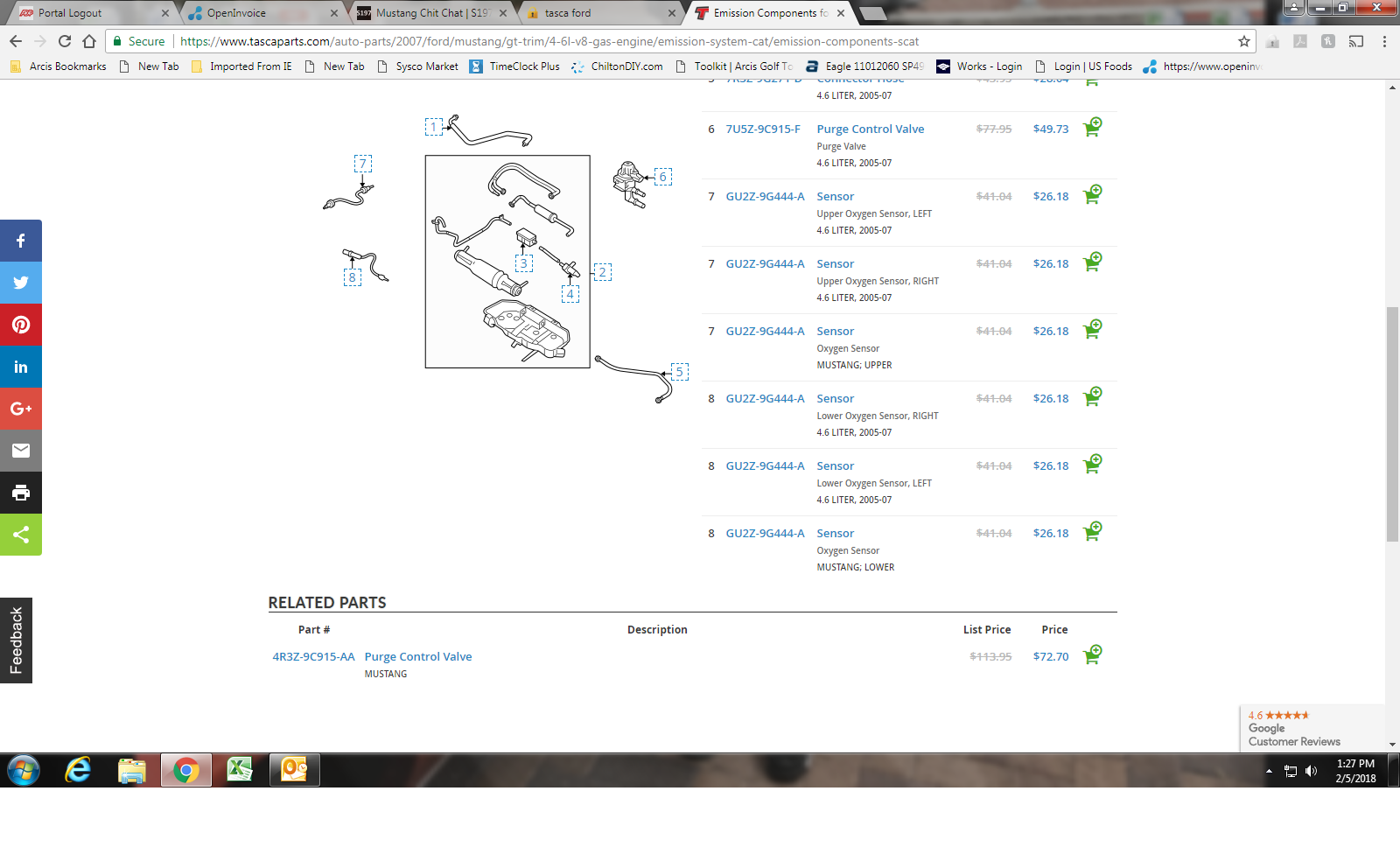

That is weird then. I have bought replacements for the front and the rears and bought the same part number. I have found some of the connectors are a bit different but they all plug in (some you have to cut the little tab). Here is a screen shot off of Tasca's website that shows the same part number for all four sensors. Every once in a while I get a lean code or O2 circuit stuck high, is this because I have the wrong sensors in there or something else? When I clear them they don't come back for months.
I think the consensus is that the batch of sensors installed when these cars were built are discontinued now and Ford went to a single part number for front and rear sensors which is why you see one part number for all locations. Doesn't mean that is ideal. I thought the rear sensors are calibrated differently than the fronts because the fronts are expected to react quicker. If all sensors react at the same rate wouldn't there be tuning issues?

I wasn't saying they are the same across all brands. I was responding to 07Boss and saying the Motorcraft line has the same part number for front and rear.
Gotcha, and agreed
They were different part #’s in 2007 don’t even look the same and now the motorcraft front and back use the same part. They don’t make a front and back only one. Saw the same thing on Tasca and rock auto but decided to Confirm this with Steve @tasca and my tuner.
