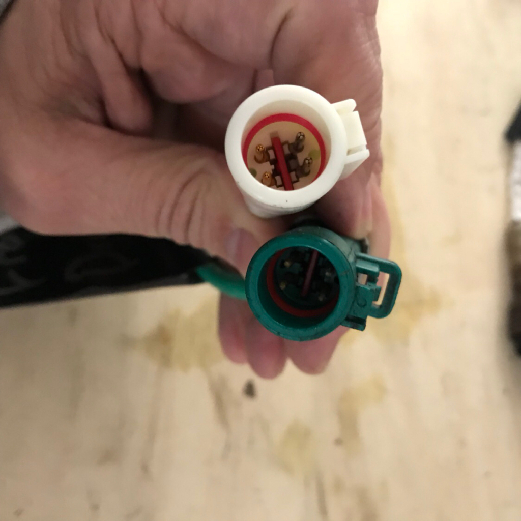

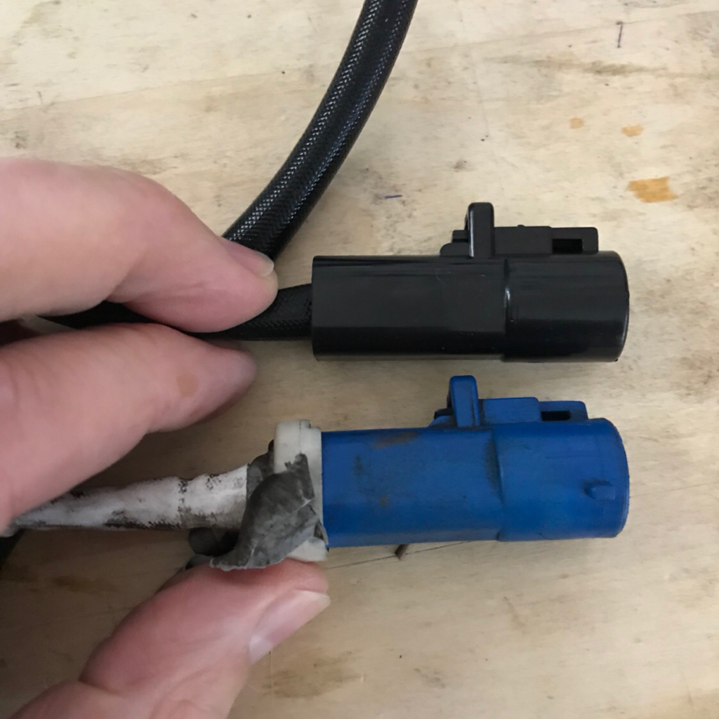

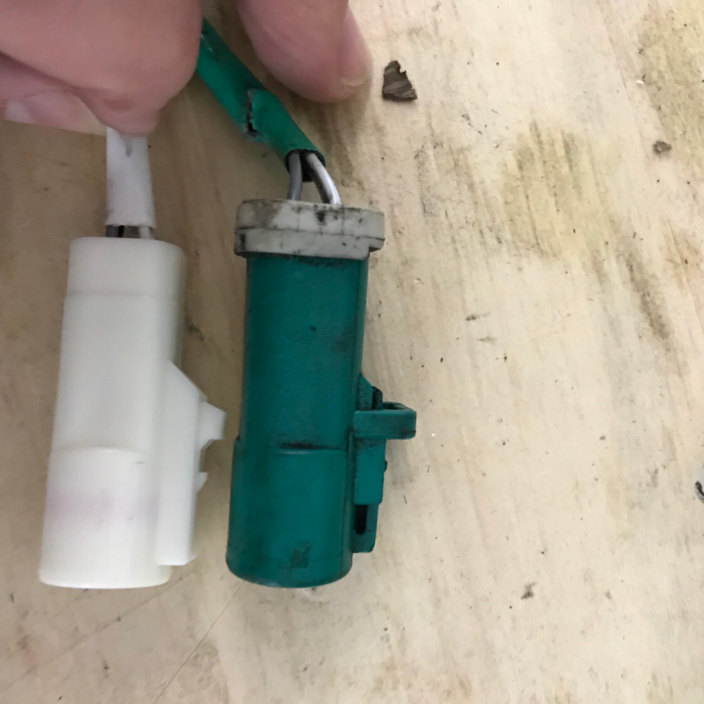

Well my point was that Lito said they are calibrated differently. If they are interchangeable how can they different? I'm not sure which sensors I have where. I bought a few at a time and changed them out whenever. Can't remember which ones I put where but I use the BBK extensions for all four and I had to cut the tabs off a couple of the connectors. I always assumed the different color connectors and tabs was so you couldn't match them up with the factory harness in the wrong spot.
Heaten m90
Jun 3, 2017
335
8
What impedance are you talking about? Extensions don't require any tuning changes. Going to headers usually does. And those changes are to heater duty cycle and transport delay.
I've used extensions in the past as well as extended wires by soldering in longer wires. No issues either way. Just cut the tabs as needed.
Sent from my SAMSUNG-SM-G935A using Tapatalk
Well just that, they’ll take forever to warm up. Lito said mine took awhile to heat up because I made the whips wicked long.

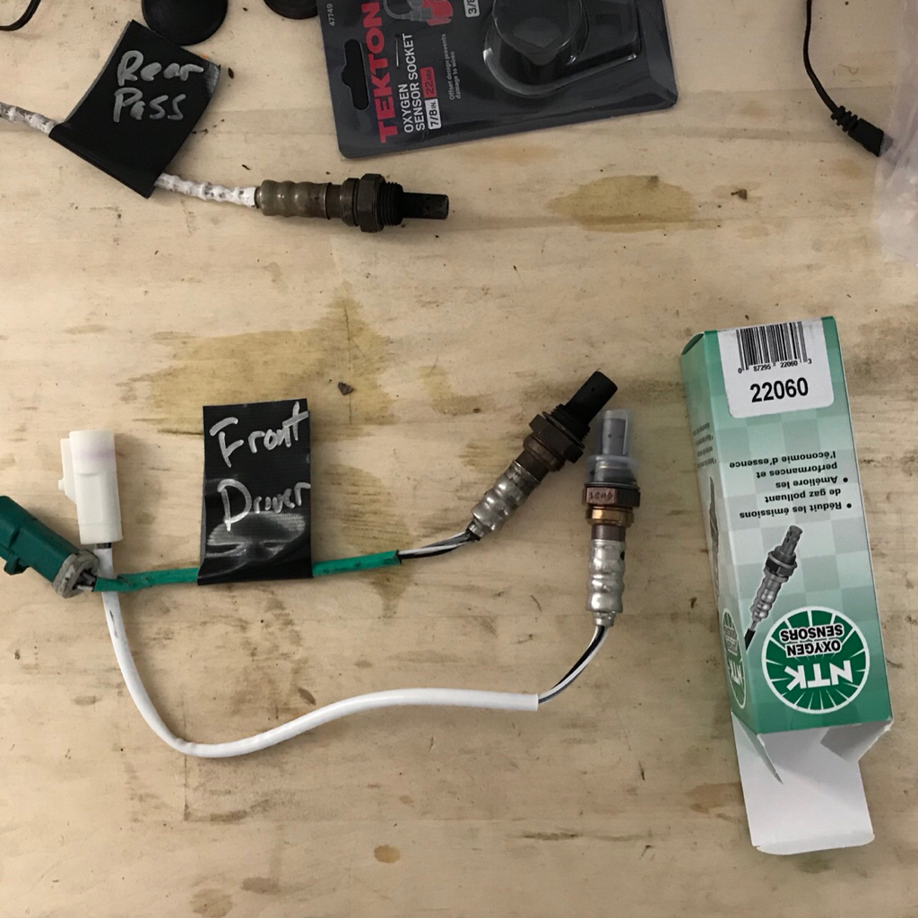

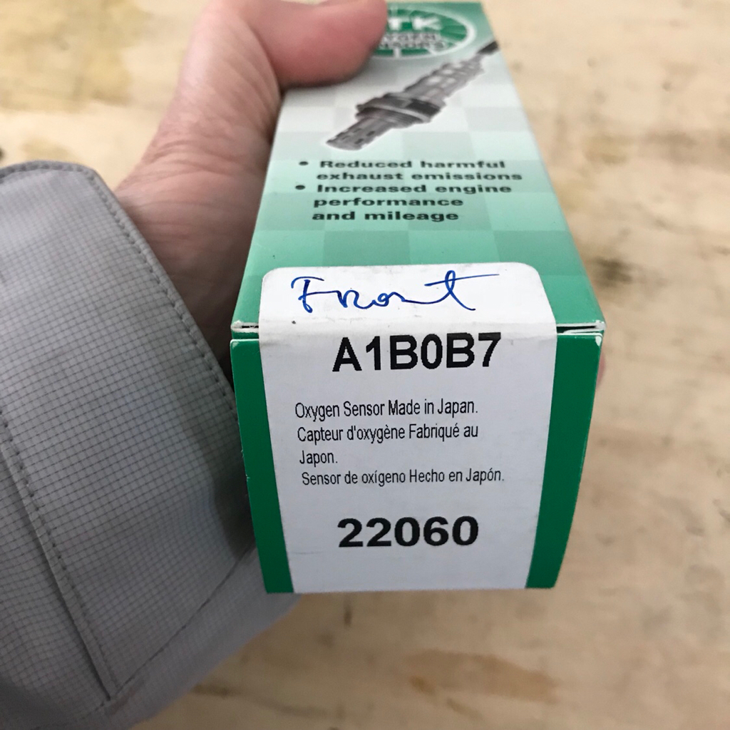

Thanks @07gts197 and @lito for good advice will see once they are hooked up if i get any error codeshttp://www.s197forum.com/members/07gts197.166612/
Front OE vs NTK 22060

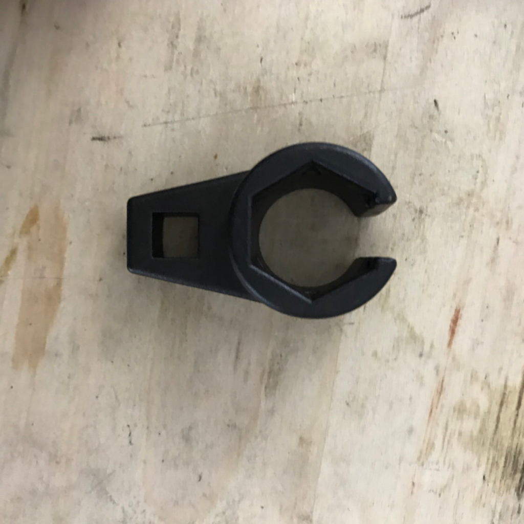

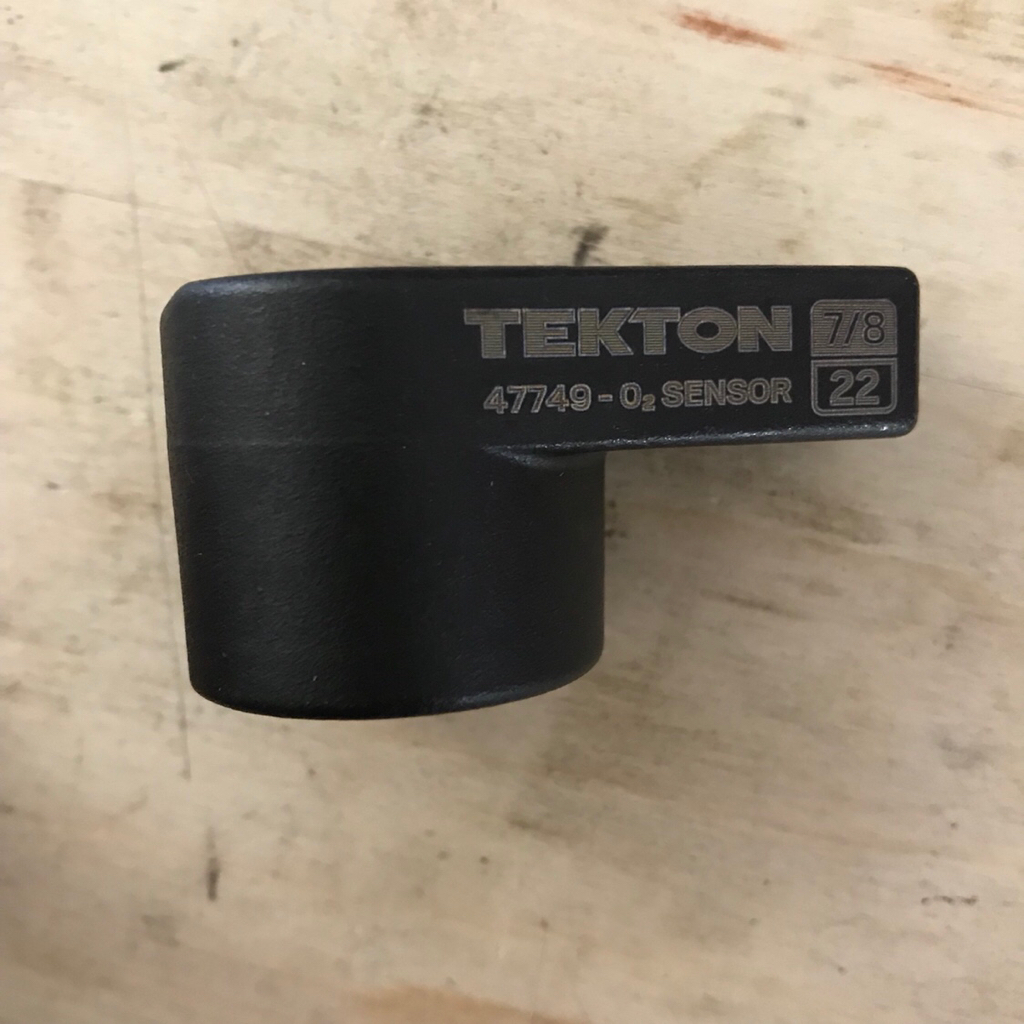

I have one of those tools and just about threw it in the trash after trying to use it on the bank 2 front sensor. I bought one of those sockets that is pretty much a deep well with a slit cut in the side for the wiring harness. Much better imo.

Interesting, may I ask why the NKTs? Everyone I've previously asked including the guys at my local Mustang shop specifically suggested I purchase the Motorcrafts.
Motorcraft no longer offers the original sensors, previously they had 2 part #'s upstream and downstream and now they only have one part number for both locations
NGK/NKT still offer the original upstream and downstream and i was tolf they actually made the original OEM's for Ford, but never verified this

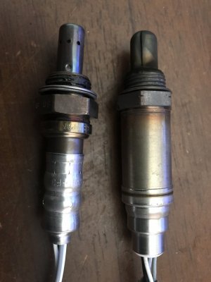

Just to give some closure to this old thread...………….

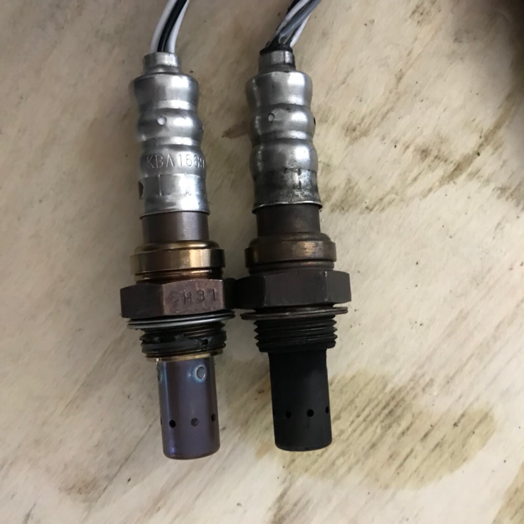

The Ford Motorcraft replacement O2 sensors (part #GU2Z9G444A) are simply the Bosch part #15717 exact fit upstream O2 sensors that Ford is now using as replacement O2 sensors for both the upstream and downstream O2 sensors for 05-10 Mustangs instead of the NTK's (part #22060 upstream, #22500 downstream) listed in this thread that Ford did use as OEM when these cars were built.
Here is a picture of the Motorcraft part #GU2Z9G444A O2 sensor along w\ a picture of same sensor beside of a NTK part #22060 upstream O2 sensor for comparison:
The reply below was all the closure this thread needed
No, the sensors that came originally in the car ARE NOT THE SAME. Ford is doing something weird with the sensors for the old cars, I have had customers get new batch sensors that Ford indicated as correct for the cars, not working.
Their calibration and characteristics are different.
Bosch should not be used in these cars AT ALL.
I would just get extensions and be done with it.
