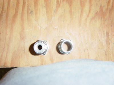

I have some 02 extensions for my headers. I plan on stacking them by 2. ( they are each about 1" long) Anyways, the hole through the middle is just over 1/2" Im making a restrictors for the ends to let less exhaust gas get to the rear sensor.
What size hole would be best to put in the restrictor plugs ? Im thinking about 1/4" but not sure.

The extensions come with a hole in the middle.It is large enough to clear the sensor probe ( end) . I want to restrict the amount of exhaust flow that the sensor actually sees. Many of the extensions ( spark plug anti fowlers ) have a smaller hole in the end. Guys drill them out to accept the 02 sensors. The ones I have are already drilled out to accept the sensor ends and I want to make plugs for the ends to restrict how much exhaust flow actually reaches the sensor.
There is a company who sells extensions, with 3 different orifices for the end to tailor the flow.
Making restrictors isn't a problem for me as Im a machinist. All I want to know is how big the hole should be in the very end of the extension , where the exhaust flow enters.
Make more sense ? Just tell me what sized hole to put in it, and Ill do that.

Here are some pictures, to better clarify. At present, I have a 1/4" hole in the end of the sensor extension that screws into the H pipe.

Those are called non-foulers.
You leave the last fouler as is, it already has a hole in it.
I passed emissions with mine, 1/2" through the first one and leave the second one alone.

Ive seen where some guys restrict the opening, because a lot of the non -foulers are restricted to less than the 1/2" size required to install the sensor.So they drill out the last extension, and leave the first one alone. And there is one company who sells non - foulers with different sized orifices.
Can it cause any problems if you restrict the opening size ?

By last fouler I mean the one that touches the pipe not the one that touches the sensor. you leave the hole that comes with it alone and small as is.
No it won't cause any issues, the o2 sensor is just "sniffing" less exhaust.
The 2nd o2's do NOTHING but check if the cats are working correctly, you don't need any different sizes, just drill it for the sensor size and leave the second one alone :)
