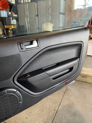

I went with plastic “Coverlay like” ones from Amazon. Fit was very close to perfect Had to lay weights on panel overnight for silicone to set. 5AE4AAE5-7079-4B14-A45E-C91F0DC2A3AC.jpeg

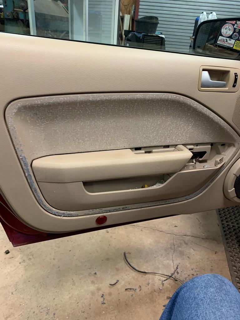

No! You cannot remove all the factory adhesive. It cannot be done! The factory adhesive is some kind of epoxy that glues the felt panel to the door panel. This adhesive actually heats up when curing and melts the felt into the plastic! Trust me I tried for months, any and every tool on the market and chemical imaginable to remove this adhesive. I eventually just bought the Coverlay and put it on the panel.
This is after months of trying to clean this panel so it would look like just a standard panel.

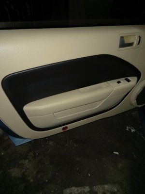

Then you should have no problem with fit or adhesion. As a retired carpenter, I have a variety of sharp wood chisels. They worked well on getting the old backing off.
This is the only thing I found that would remove it.
