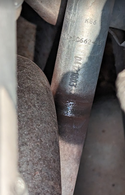

My mistake, it indeed is a header tube touching the steering shaft.
I'm not sure of the brand but with the hood open and my son as an assistant turning the steering wheel in addition to revving the engine, that's it.
You can even see where it has been rubbing.
I had that problem on my El Camino but I dimpled the tube before doing the final bolt down.
It's going to be a real PITA to attempt any sort of dimple with how close this thing is.

If you remove the driver side bolt that holds the steering rack, and loosen the passenger side. You can slide the rack forward. You can then remove the steering shaft to give you room.
The good news is, denting the header tube does not affect performance. The guys on “Engine Masters” proved this.

If you done want to dent the header... Several vendors sell adjustable height motor mounts.
Also, a simple large washer under your existing motor mount might to move the motor up a few might work too...
