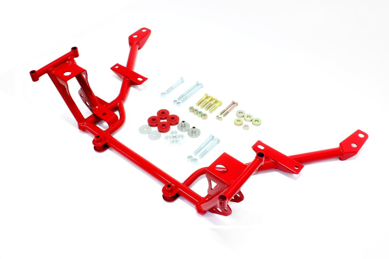

We have not decided what to do with the steering, the solutions we have found so far won't allow to run a supercharger later on so we are still looking. Even considering switching k-member and installing an EPAS rack.

The problem with the damn EPAS is there is not tubular K-Member for it yet. You could modify the BMR I suppose...
Sure there is. :highfive:

haha, damn it, i swear i just looked not but a few weeks ago!!!
Guess I know what I will be ordering when I get home... :)
