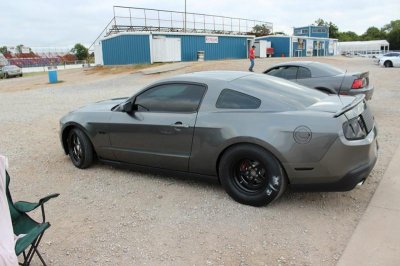

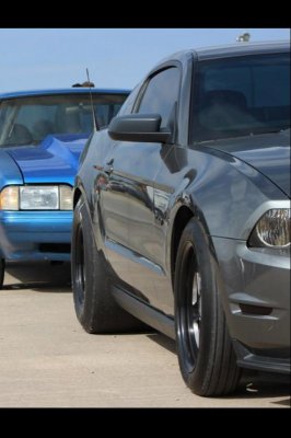

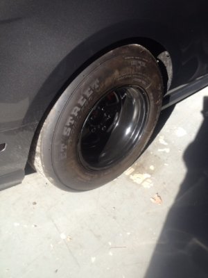

Once again these are 11" wheels and I have a set of 12" with 275DR and they are a bit too large for the wheel well. Still some would run those as well.
Looking for that pic as well.
275 on a 12" wheel
the 12 is a bit too wide but then again I like them to squat on launch. This is a closer look at the the 275R+DR on the 12". I no longer run them and just run my 11"
