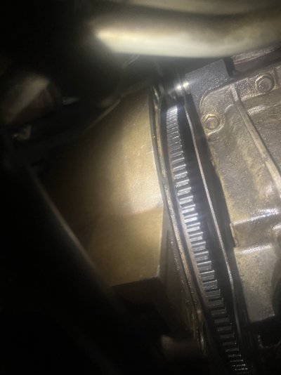

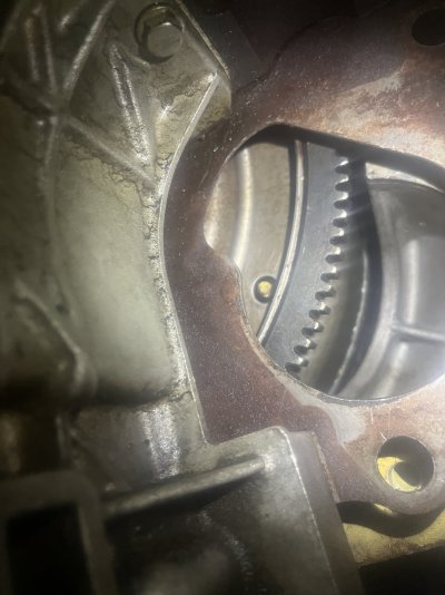

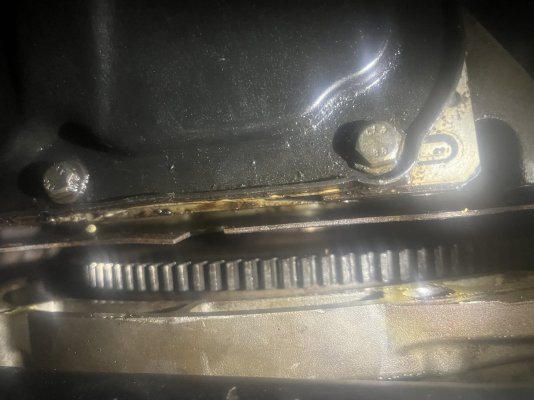

The post above, look all around the bell housing, ensure it is clear. Wire looms and whatever brackets on top cause this a ton. Next ensure even gap all around the bell housing as it has to be square. next, nope to spin the converter by hand is the answer. Worked in trans shops over a decade doing this, it is way easier on a lift, and correct trans jack, but can be done the way you are doing it. next, if the gap between the bell and engine is not even all the way around, at times the front of the engine needs a little lift to get it even. post some photos of the gap, top, sides and bottom. the issue will be very apparent. Whatever you do not try to "bring it together with bolts" as this will 100% of the time break off the bell housing.

Got the car level and tried to manhandle it for a couple hours to no avail. Here’s some photos of what im working with. Not being square is feeling like the most likely culprit.

Looks like your getting the Trans to the point of entering the locating dowels, Is the trans entering the dowels at all? if not just double check they are in good shape (round and not disfigured) and check the dowel diameter compared to the transmission mating hole diameter even if it is the same as your old one. They are quite a close tolerance to the transmission locating holes.
