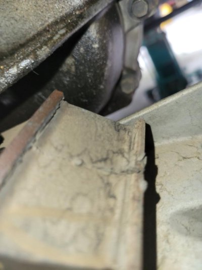

I am going to replace the transmission mount on my 2005 GT. I see there are a bunch of aftermarket ones and OEM seems to be discontinued.
DEA, API, Anchor are a few I saw. Would like to get one that is considered good by those who know. My car has 155K on the original and even if it hasn't failed it has certainly served it's time. There seems to be a separation in this pic although it might be a shadow.trans mount.jpg

I replaced mine about 3 yrs ago.........I chose Anchor since I read from research that Anchor also manufactures parts for the OEM's thus the part would most likely be manufactured to Ford's OEM design specs at a minimum. Mine was the OEM production line original, wasn't as bad as yours is showing to be (the crack is evidence that the rubber bonding to the metal is starting to fail........mine was off a '09 vs yours @ '05 so yours has a few more yrs wear.........)--I changed mine due to its age & me making a LOT of 1\4 mi WOT hits during self-tuning (thinking it was getting soft............).

If its an auto id go for the stiffer option as them auto boxes weigh a ton, I'm only guessing the manual gearbox would be a lot lighter. I personally wouldn't worry about a small breakaway from the steel like that at this point unless the rigidness has gone out of the rubber. or its the rubber is perished looking
