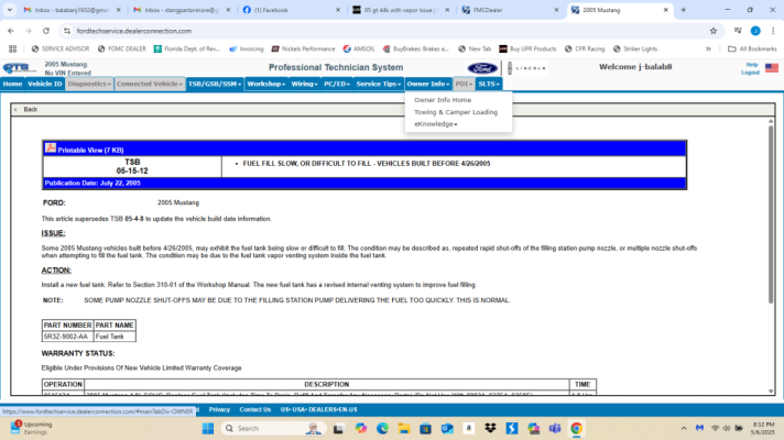

Thi swas the TSB performed for the problem. I know because it happened on my wifes 05 and oh yeah....I work for Ford.
So I have a question for you since you work at Ford as well and you said your wife had the same issue as my vehicle however you were able to get the fuel tank replaced. When the mechanic or tech worked on my Mustang they apparently did a air evac back flow pressure test to check the valves and vents and apparently it caused a pressure build up to wear gas came out the neck and splattered all over the car. My husband was concerned because he said nothing should have that kind of pressure going through the vents or valves in that vehicle's fuel system however since then I have continued to decrease in gas mileage as well so when I did a Google research it also stated that if too much pressure is put through the system in a reverse test then it can definitely wreck the valve or the vent vapor vent and cause decreased mileage so I just wonder what your opinion might be on that because now this dealership is fighting me and saying that they didn't do anything.
