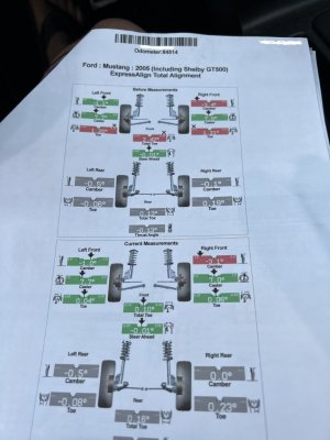

    My front passenger camber is -3.1 degrees, but the driver side is within spec. Anybody have any ideas what this could be? I don't really want to run a camber kit since driver side doesn't need it. The first alignment shop said they think its a bent strut but were unsure and said they aligned it best they could. Another alignment shop said I need the camber kit. Would appreciate any input. I attached the most recent alignment report. Thanks in advance mustang alignment.jpeg

    Inspect your ball joint and control arm bushings, I am leaning towards a blown out ball joint. If the joint or bushings are bad, you are better off buying a new set of control arms. I installed these on my 08 Bullitt a few years back.

    Two degrees difference is more than just a balljoint IMO.
    One extra degree moves the top of the strut in a lot.Clearly obvious after adding my cc plates.
    I would suspect a bent strut, bent spindle, or possibly camber bolts were added. Or all of the above. That much difference is not from worn parts.

    Seeing as your caster is off by some too, it's definitely a bad part.

    Thanks all.. finally got it pulled apart, the Ball Joint shaft was bent..some how the shaft got bent and that created the strange angle
