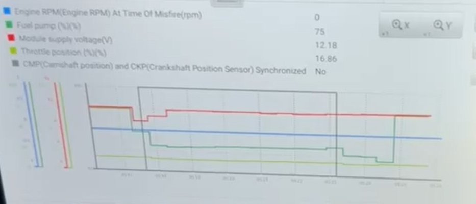

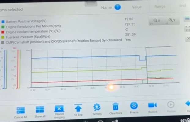

I just get a better "tester" to show what is actually happening.... there's few observations:
  • Fuel Pressure: Stays 260–300 kPa while running. Spikes to 436 kPa the exact moment the engine dies. To me, this suggests the PCM is cutting the injectors while the pump is still pushing.
  • Sync: CMP/CKP Sync stays "YES" while running. It only drops to "NO" after the RPM hits zero. So, I'm ruling out bad crank/cam sensors for now.
  • Codes: Getting B1557 (Ignition Run/Start Circuit) and U1900.
  • PATS: Theft light is NOT flashing rapidly.
Alternator was bypassed during this test to rule out AC ripple.
Any ideas?
juba
Feb 12, 2026
Finland
If you hook up a scan tool (even a cheap one) to the OBD connector,go to the live data's RPM reading,crank the engine and if it shows 100-500 RPMs then the PCM is getting a signal from the CKP and you should look elsewhere to solve your problem.
When the car starts, the rpm goes to near 800 (pic 1, engine is running), for some reason fuel pump is going 75 %, but it happens after the engine stops (pic 2), just wondering why so.
