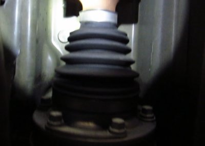

2007 GT500 stock driveshaft boot dried and cracked
shelbygirl
Jul 20, 2016
19
We have 86000 miles on it. Had the car shipped to Europe. We are driving in Czech Republic and had it up on a lift for an oil change. The mechanic pointed out a completely dried out driveshaft boot, with a large crack in one section. Ford in the US, says that it is covered under our extended warranty, but only on US soil.
The Ford dealer says that we cannot purchase a boot, but we have to get the entire rear section of the driveshaft, p# BR3Z4R602H, and it is $620.
We checked with Fedex, and shipping it over is $947.
options, that I know of are...
1: Bite the bullet, have it shipped.
2: Have it shipped to someone in the states, remove boot, ship boot for $45. Have boot replaced here. Done.
3: Buy an 4" aluminum one piece driveshaft. $795 plus shipping
4: Wrap cracked boot with Silicone Rescue tape. Keep driving.
5: Sell car here in Europe
6: Take your advise...
Thanks for your help.

Someone here has to have a stock DS in a scrap pile and can send you the boot in an envelope for $8.
Gabe
Whippled Coyote
Aug 7, 2011
8,599
1,820
Isn't it just a regular rubber boot?
I would think a European car would have a boot that would work.

After taking off the bad boot.
So, tomorrow, I am going to take to a local shop here in Prague. I will see if they can take off the boot so I can see any damage inside there.
Should there be any slop in the driveshaft itself? back and forth, side to side, up and down, etc?
I think I could even buy a plunger with an accordion style, and put that there as an interim fix.

Option 3 as well, but get a 3.5". The 4" is just too large and could have clearance issues.

Here in Prague, the Ford service advisor says they could order the DS from the US, but would take too long to get here. We have to leave before it would arrive. I am awaiting word from Ford Extended Service Protection people to tell me if I have get a DS shipped over here, who actually has to perform the work, to keep the car under warranty? The dealer in Prague, says we would have to pay cash to get the part and get the work done, then submit a claim to Ford ESP in the US. They did have the car up on the lift again, and there is no play in the DS, so that is good. They said it would be fine to drive up to Denmark (our next stop). Thanks guys for your help.

Better pic of torn DS boot
Found a new DS in New Jersey $620 and shipping is $150.
