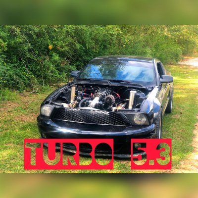

07 mustang
Iron 5.3 bored to 5.7
Summit pro ls forged rods pistons
Sloppy stage 2 cam
PAC springs
Stock heads
ARP studs
Ls7 lifters and hg
Twin gt35r turbos *ebay
Snake eater 1500cc injectors
Twin walbro 450’s
Flex fuel setup
Fti powerglide
Fti 3800 stall convertor
Built 8.8
3.55 gears
Holly terminator x
On pump 93 on 11 lbs right now just street tuned it.... it fucking flies. It’s faster than my old built 4.6 with a precision 71mm on 18lbs
Only problem is it keeps throwing the belt ordered a manual tensioner the 200k mile one isn’t handling it
