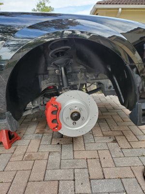

Jan 19, 2021 #1 cdydjded Junior Member Joined Jan 19, 2021 Posts 2 Reaction score 1 I did the GT front disc upgrade on my 2007 V6. Very easy to do. All you need is: 2011 GT caliper brackets 2011 GT rotors You use the V6 calipers & brake pads. I believe this will work with 2005-2009 V6
Jan 19, 2021 #2 DieHarder Senior Member Joined Nov 9, 2019 Posts 1,864 Reaction score 1,087 Nice work. Q: Does it stop any better?
