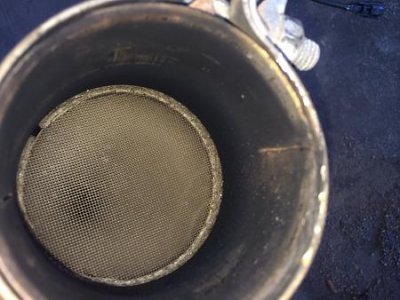

I don't disagree. I decided to look more closely. There is literally no signs of an exhaust leak at the header. It's just not it. I've put a stethoscope and listened, still leads me to the flywheel. On another note:
These are the catalytic converters, one side compared to the other.

eighty6gt
May 9, 2011
4,292
403
I see a catalyst matrix, then I click for a larger version and I see a pipe with nothing in it.
Edit: now I see two of the same photos in two posts.
avinaj80
Feb 2, 2010
1,479
Stock or aftermarket cats? ONly time I've seen that is with the cheat ass cats Bassani uses...
