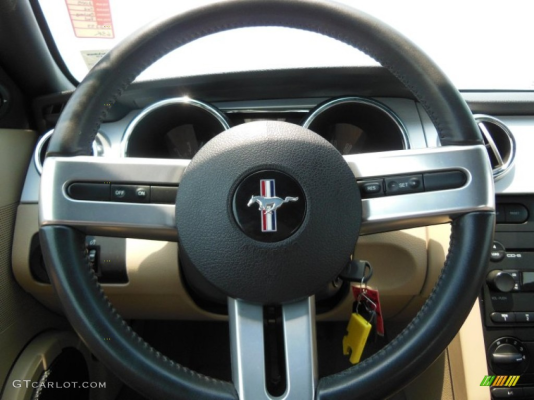

let's assume your current steering wheel looks like this
It does? Ok great. So you basically only have 5 buttons you need to simulate.

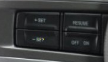

What buttons does the new steering wheel have?
Cancel/Resume as one
On/Off as one
Set-
Set+
Uh-OH, this only has 4 buttons.

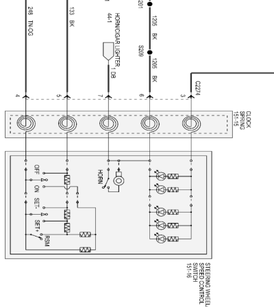

Here's your 2005 wiring diagram.

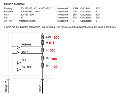

Unfortunately, Ford didn't provide the resistance values on the diagram so you will have to find them youself. Don't be upset, on the 2013 one, they provided resistances, but they were all wrong.
Pin 4 supplies a voltage,
and Pin 5 is where it awaits the return signal.
So you have 5 buttons you need to simulate. But wait! There is technically a 6th. The resting resistance.
Looking at the left side of the diagram, we are going to name the resistors 1 thru 5 starting at the bottom.
When the car is at rest (no buttons have been pressed)
The voltage comes in through pin 4, goes through resistor 1, then goes up and makes a left into resistor 2. Then makes a right and goes up through 3 and 4. Then it goes to the to the on/off side of the car and through resistor 5 and back out through pin 5.
So Your resting resistance is R1+R2+R3+R4+R5. So while your steering wheel airbag is out, and the steering wheel is unplugged from the car, put a multimeter in Pin 4 and Pin5 and measure the resistance, Write that down.
Same logic, but lets look at the ON button.
When you press ON, you get to skip R1. Follow the path. you start at R2 through R5.
Measure that, and now you get a Resistnace which is R2+R3+R4+R5. doing math, you should be able to get R1's value.
Ok, so now you've done that for R1 through R5. and you've sorted the buttons largest to smallest based on Resistance...
Now you should have
Resting (largest)
On
RSM
Set+
Set-
Off (lowest, 0)
Looking at the work I've done on the S197 2013
You're going to have a rough time, because the ORDER is not the same.
Resting
RSM
Set+
Set-
On/Off.
This means you're going to have to run trace wires and basically change the resistance ladder. Can it be done, yes. Will it be easy, no. Will I help you if you want? Yes.

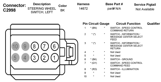

You know what, I realize I didn't answer your question.
Here is the pinout for that connect.
this is generic for a 2013 GT car. Usually, they will specify if there are options that are included or not. I'm willing to bet that in the 2013 Non premium cars, they have the same pinout for those except for the information select. Its probably also why there is no listed color. If you buy a used one and open it up and take pictures of the circuit, I could tell you in a few minutes.
