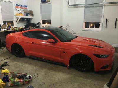

Here she is! Just finished! Will upload better pics tonight.

Orange and Black - Go Giants!!!
Now that's what i call slammed!

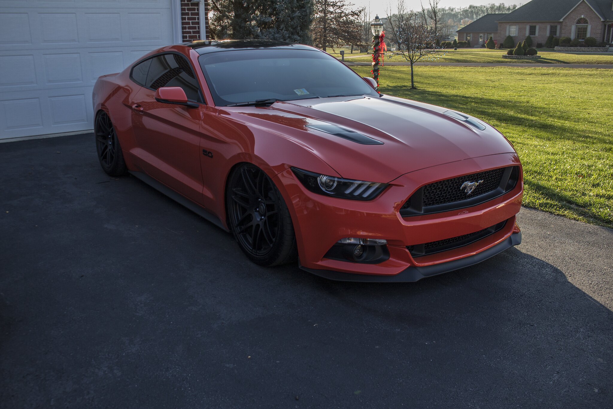

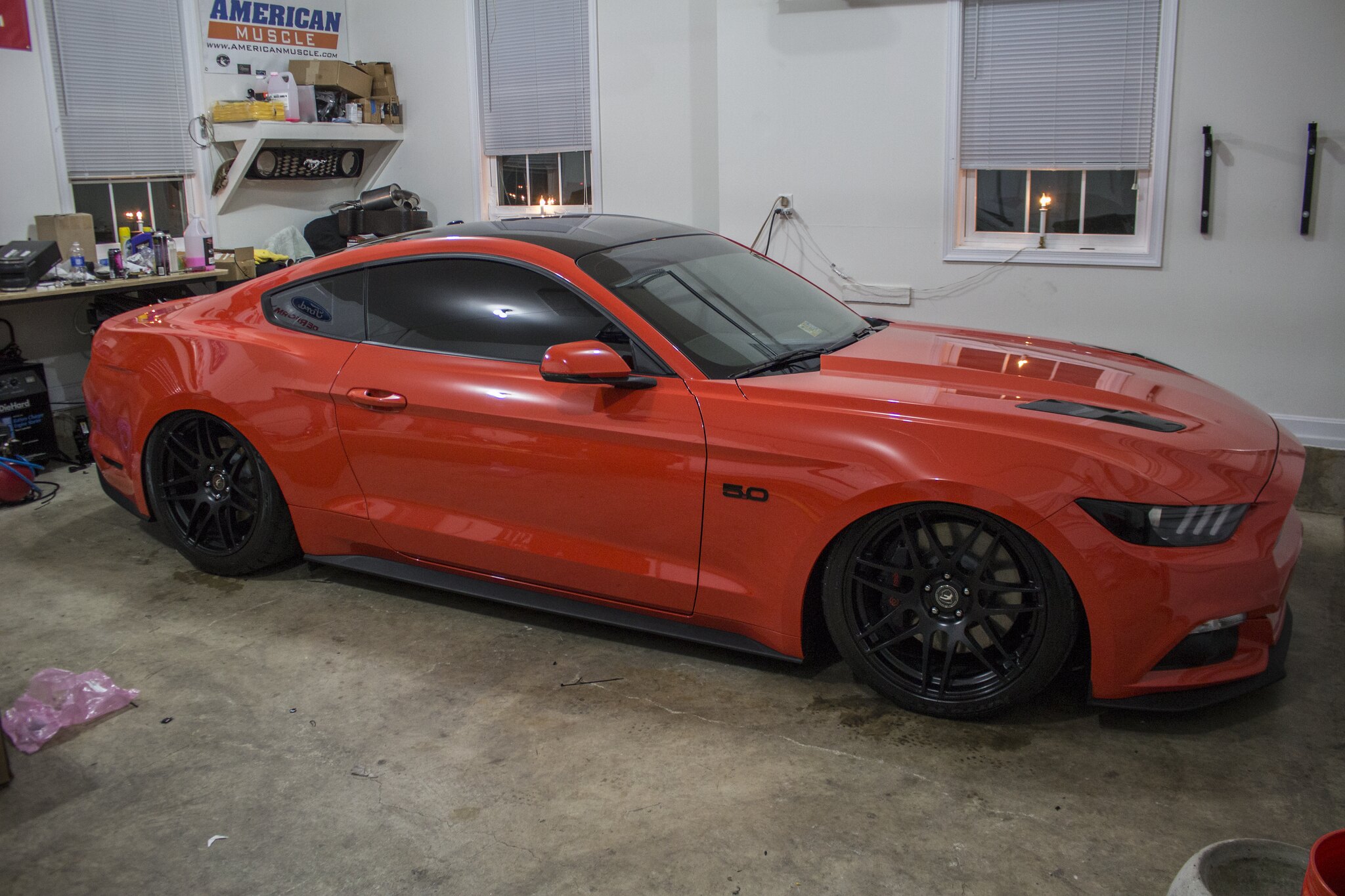

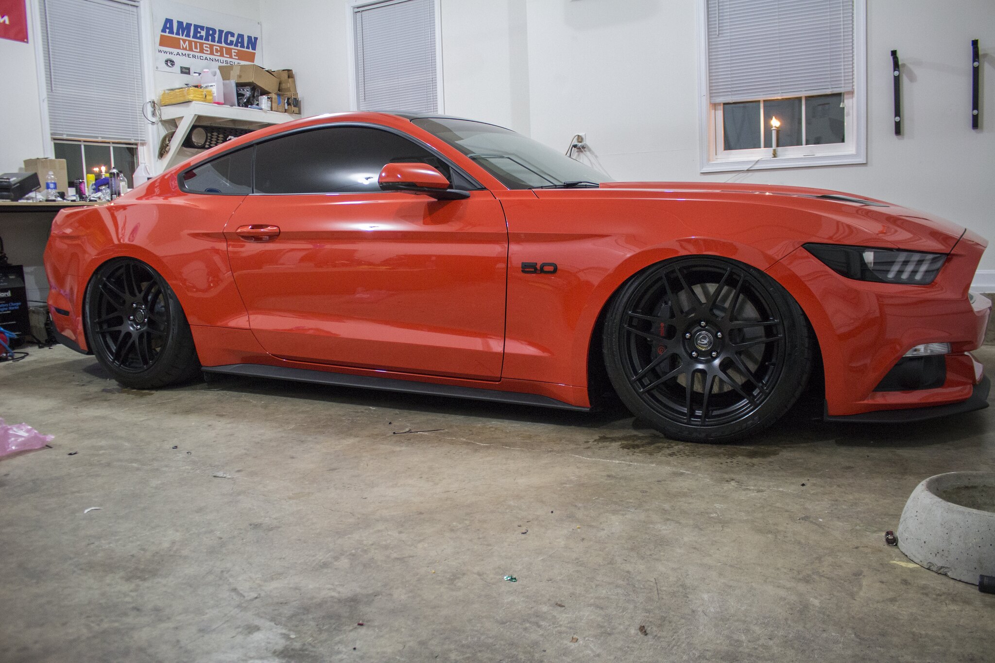

Here she is fellas! Aired out on F14s! Gonna try and get some actual pictures this weekend.

Those are the same F14s that you had on your S197, correct? Great to see that the offsets work on the S550.
Your car looks amazing on air with the ForgeStars!

Yep! Same wheels off my 2011. Other than needing new lugs, everything is the same. I was quite surprised that the 315 would fit aired out. Thanks Chip!

Excellent stance, nice and low. Welcome to the Air Lift Performance"Bagged Gang"! The orange looks fantastic with the black F14's.

Thanks man! I love how it turned out. Not too many S550's with F14's too, but I'm sure that'll change soon lol.

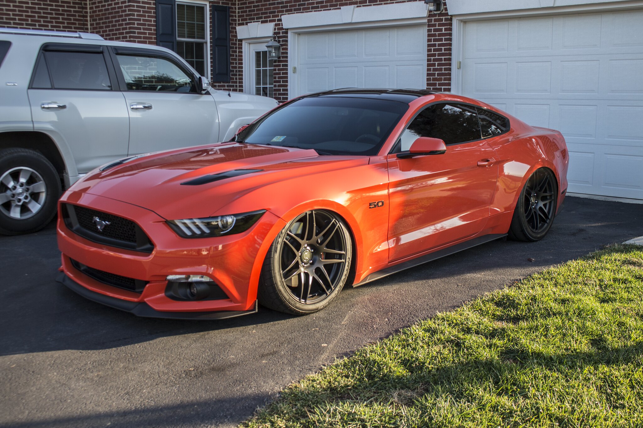

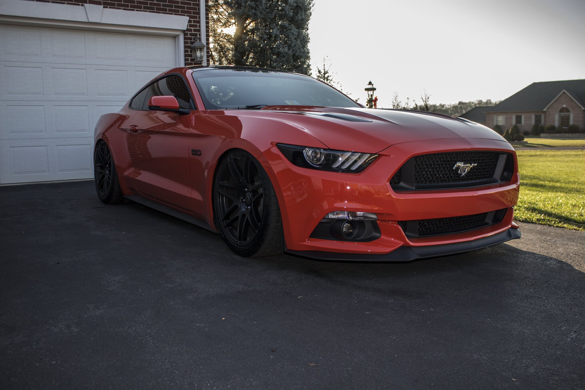

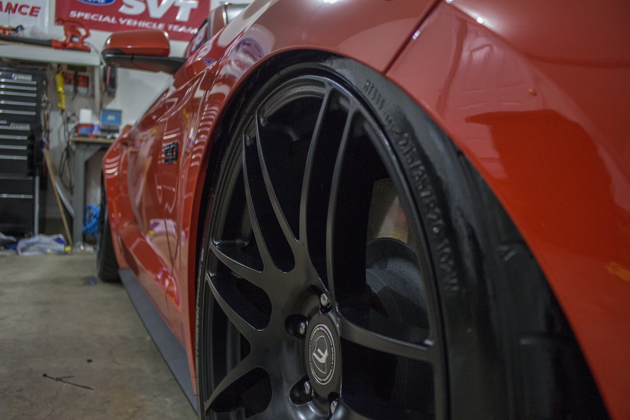

What are the specs (width and offsets) on the F14s. Fitment looks perfect
Rear is 20x11 (+55mm Offset) Nitto NT05 315/35/20
Front is 20x9.5 (+29mm Offset) Nitto NT555 275/35/20
Wish I could take some better pictures, but unfortunately I have drill all weekend.

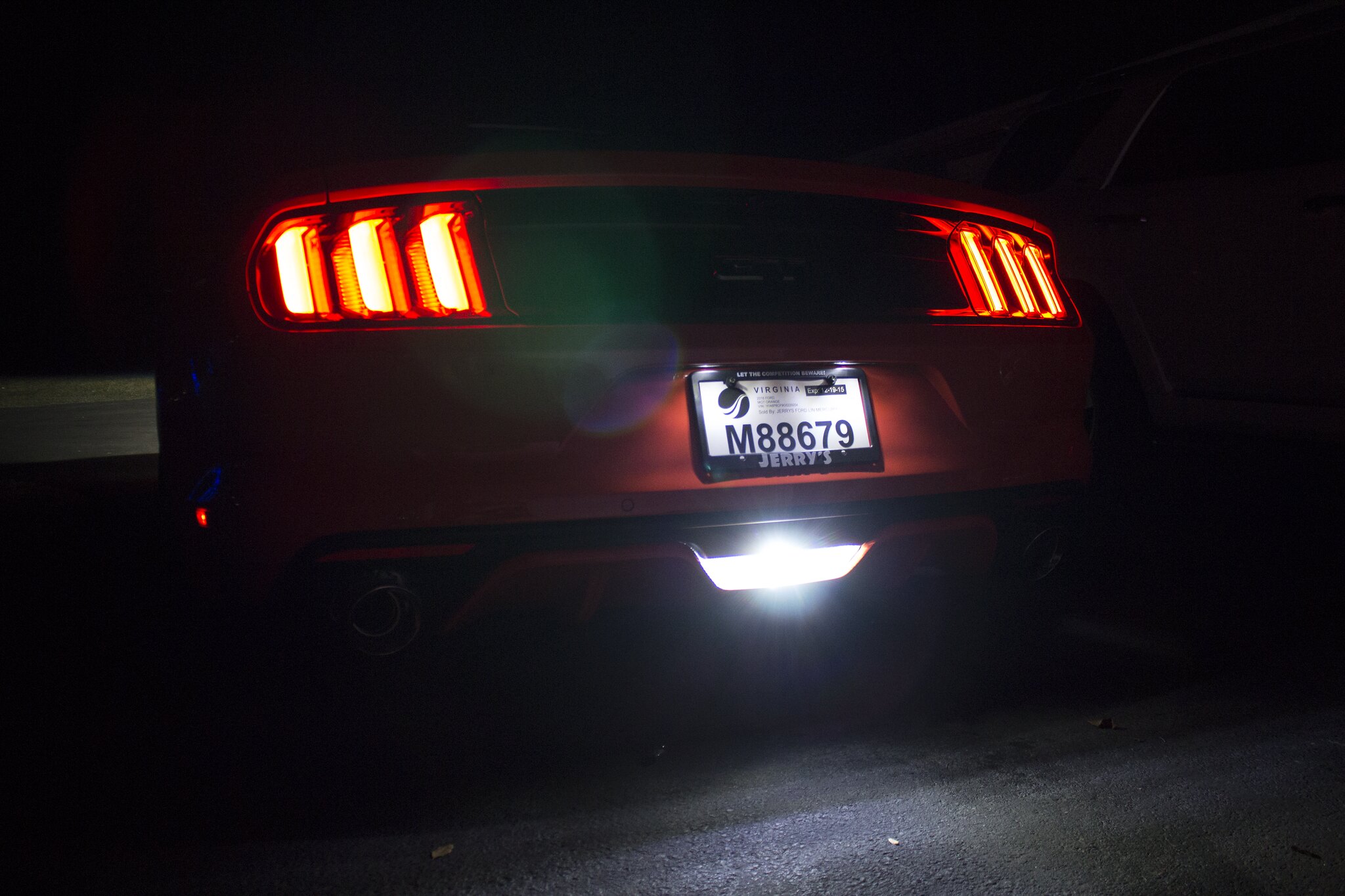

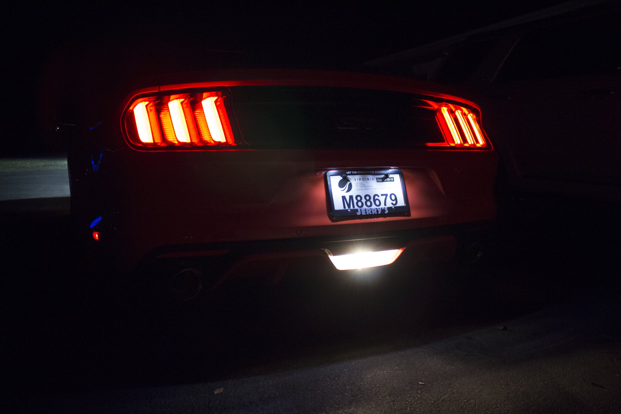

Also got my order from Diode Dynamics from Black Friday today. Ordered LED Map lights and Reverse Light. Here's some pics of the before and after reverse.
Stock Reverse
Diode Dynamics XP80 (510 Lumens) LED Bulb
