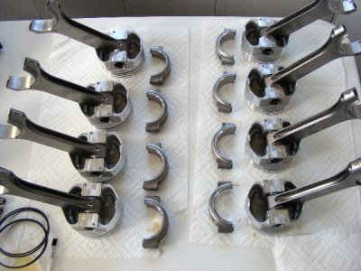

I bought a new FRPP 5.4 iron block and FRPP 5.4 Lightning forged steel crank, Manley H-beam rods, Probe flat top 5.4 height forged pistons (real >11.5-1 compression), Melling hi-vol billet gear oil pump, new 2001 Cobra heads with new 2001 Cobra camshafts, SFI steel flywheel and damper, new valve covers and timing chain cover- custom powder coated bright metallic silver, 2007 GT500 oil pan/pickup, and tons of other small parts to finish the engine.

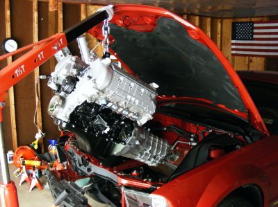

To actually perform the swap, I had to keep two things in mind: 1. GT500 engine wiring harness and computer 2. the 4.6 and the 5.4 have many similar dimensions- so don't over-think it.
This swap could've been tons easier, made more power and probably cheaper if I had: a. used a manual steering rack instead of power b. deleted my air conditioning system c. used GT500 type heads and a Cobra R intake.
To get the engine in the car, I got a pair of the iron GT500 mount "ears" and bought aftermarket poly motor mounts for my own purposes (I don't like the squishy factory ones, but you can use them). You can use the 05+ GT or GT500 oil pan, just make sure that the pickup tube height is good off the bottom. You can use the factory Cobra iron exhaust manifolds. The transmission mounts are the same from the V6 and only required flipping the aluminum trans crossmember over (along with flipping the exhaust hanger mounts). Now you have the engine and trans in the car!
I got lucky and scored a 2007 GT500 computer and new engine harness. I bought a 2007 GT alternator and 2007 GT battery harness (I was using a GT alternator in the GT location, not the GT500 location). The air conditioner compressor is at the same location for the GT and GT500, but different from the V6, so some (not all) of the A/C lines needed to be purchased. The V6 power steering pump is different and a GT pump and the pressure-side hose/line is required. I decided to use the V6 heater hoses (cut and spliced to standard heater hose and a 2001 Cobra heater tube setup for the rear of the passenger head and a 1994 Lincoln Mark VIII nipple behind the water pump to make the heater hoses quick and simple.
As you can see, I removed the front bumper cover and I installed the engine and transmission joined together from the top, with the hood on at the regular height of my CDC hood struts. I did it by myself without any help and not a nick or scratch (I am very careful, use a tilter and I have been pulling/installing engines by myself for 30 years).
