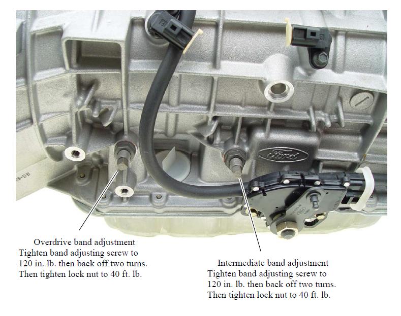

Another thing people do not know, is the two bands are adjustable,
the intermediate and over-drive band.
You do want to adjust them so that there is no slip when the bands
are applied. As the clutch material on the bands wear down , the
gap widens between it and the drum. The slip, which is a flared
shift into 3rd or O/D, burns the clutch material. Keeping them adjusted
keeps the application time and grab strength the same.

The problem is there is no room to get a torque wrench on the back band adjustment screw. I replaced the solenoid block a couple of months ago, but could not adjust bands. I bought a couple of 8 point sockets that I am going to cut down and see if that works. I may have to drop back of tranny to get the TW on the screw. I have a 05 and both screws and lock nuts were very rusty. Sprayed the shit out of them back then. Hopefully that will loosen them up.
