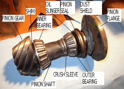

I found this picture. I have personally never changed the crush sleeve without disassembling everything. But it looks as though you could just pull the flange, seal, oil slinger, bearing, and potentially fish it out the front.legend.gif
