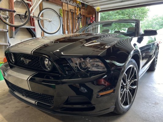

We are looking to get new wheels and tires for our 2013 GT. Depending on how it looks after that, we will determine if we lower it at all.
Wondering your thoughts on wheel/tire size.
Staggered:
Backs: 20x11 50mm
Fronts: 20x9.5 35mm
Or
Squared:
20x10 37mm
Or
20x9.5 35mm
Would love your feedback from your experience.

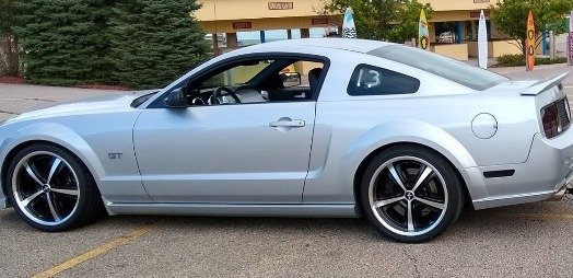

How about a set of Shelby's, 20x9, 265/30-20, 20x10 295/30-20, for $1000? I'm NW of Milwaukee. The wheels are like new, tires about 1/3 worn. I like the look a lot but I've had them for a while and I'd like a change.
MrBhp
Sep 12, 2013
1,815
1,521
Those look nice. I almost got those. I just really needed 11 inch wide. But I think those look better than mine. Especially on a black car.

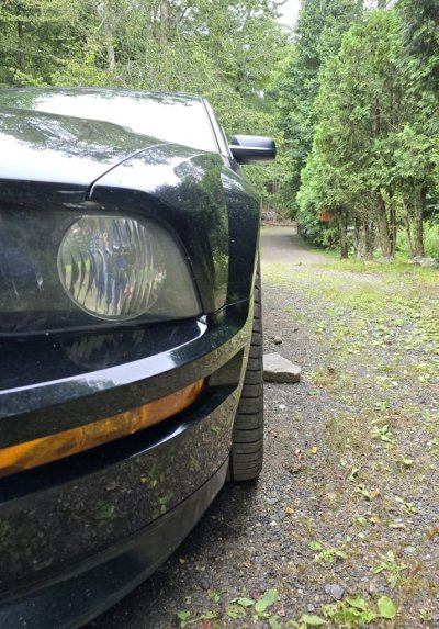

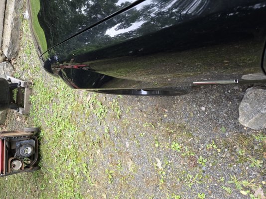

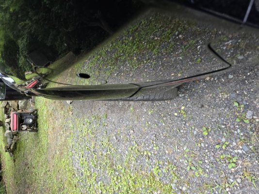

Here are some pics of my 2007 Shelby with 20x11's w/50mm bs and 20x9.0's w/30mm bs. If I didn't have -2.75 camber, the fronts would poke.

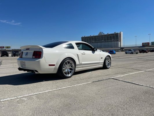

07 with 20x9.5 +40 front (3mm spacer now to clear 6 pot brembos so I’m assuming more like +37mm. 255/35 front. 20x11 +50mm rear with 285/35 (will be going wider next time around). F05E6BB1-CFAA-4A7C-A191-0F729933E22A.jpeg
