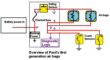

Car is a 2007 Mustang GT and I just got an airbag code 22. A search revealed I may have a bad safing sensor. I tried looking for this on Fordparts.com but couldn't find a match. Is it called something else in the catalog? Can someone please check the part number on this and a price quote if possible?
Thanks in advance

I honestly dont know where it's located. I read it's a sensor that goes on the driver's side B pillar.

Only thing I can think of would be the side impact sensors.
Has any work been done on the car recently?
