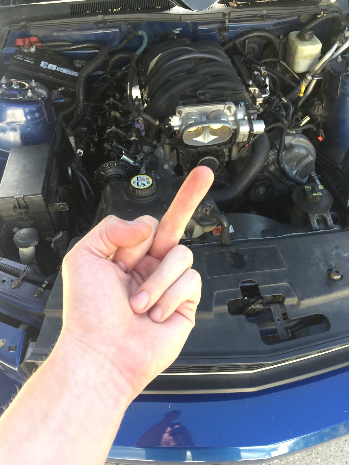

Now, I'm going to get off my ass, get this car into the garage, and start yanking a 3V motor!

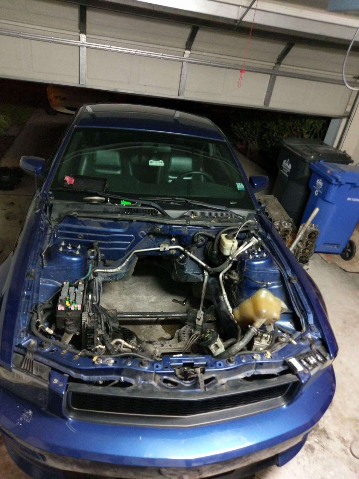

How the car was left last night. I'm waiting for a friend to come over with an engine leveler so that we can yank the engine and trans. I also ordered a blowfish bracket tonight because my car grinds second badly during a lot of quick shifts. I'm hoping this will help with that. If not, I will just deal with it until it's 6060 time.
Some bad news today is that some parts I was really hoping to have tomorrow will not make it in time. One will probably show up Saturday, so thats not too bad. The other stuff is Monday. Not the end of the world, but for sure no start this weekend. It should give us time to work on the wiring without too much distraction though.
