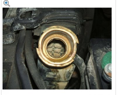

Distilled water is not any more corrosive than plain water once mixed with coolant or water wetter. If you use tap water, the minerals that are dissolved in it may react with the metal and precipitate out once the coolant is old and worn out. Leaving a radiator that looks like this.
Not mixing water wetter and coolant is a good idea. Not only does it not really work, it can create a goop that can clog a radiator. I did this in a ‘95 Firebird and had all kinds of gunk in my radiator.
