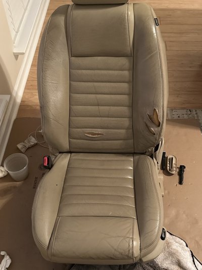

My driver's seat is rough (not surprisingly since the car turns 20 this year), I already replaced the lower seat cover because the original one split in the middle, and now the upper has a hole in the left side lumbar support. I got the lower seat cover cheap because it had white paint or something on it, but gennie leather uppers are way expensive (like $120 just for one) and the only other option is vinyl.
So I started looking at OEM seats, can't find anything locally and stuff on ebay is too expensive with shipping, and then I looked at some aftermarket seats.
Sparco makes some really nice sport seats (R100) that recline and are around $300 each, so I'm thinking about ordering one to replace just the driver's side for now.
My question is, can these be adapted to factory rails? I would assume with a little fab, it wouldn't be that difficult- Sparco wants you buy the mount, and the slider, and hardware all in addition to the seat and those alone cost more than the seat does. I just bought a manual driver's side seat track and the bolt pattern isn't too far off what I found for the Sparco seats, so I would think I could just make an adapter plate out of some steel strip. I'm no stranger to fab work so this seems very doable to me.

I know it's not hard, as I said I already re-covered the bottom. But the cheapest (and only) genuine leather cover I have been able to find was, as I said, $120 on ebay. There aren't any "pick a parts" or anything in my area. I can only find vinyl covers otherwise.
At any rate I had a few people tell me that most of these racing seats don't fit bigger people very well (I'm 6'4" and 290 lbs) and the R100 isn't very comfortable, and the ones I could use are $450 each and up. Not sure if I want to spend that much on a car I don't track or anything.
I'm actually now considering throwing some WRX seats in the car, found a guy selling the buckets from an '04/05 WRX on marketplace for $200 but he's 3.5 hours from me so it would be an entire day to get them and come back...I don't really know what I'm going to do yet.
I considered newer Mustang seats but all the ones I find are way expensive and/or have blown airbags.

Well I ended up finding a good deal on some WRX seats, gonna figure out how to swap those onto my original tracks. I've always thought these seats didn't give you much support for a sports car and these have much better bolstering on the seat back and bottom.
