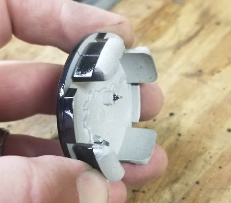

Center cap is, as far as I can tell, unchanged from the earlier cars (it's the same as the cap on my earlier S550 wheels but the center cap area sticks out further than it does on these S650 wheels, I no longer have any S197 wheels to compare it to)

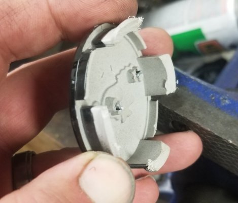

So, to make it fit you have to cut off some of the inside of the tabs, and you also have to cut off the posts for the pony emblem. I cut the tabs with my portaband on a table, I'm not sure how you could cut them otherwise. The posts I just snipped off with side cutters.
Even with all this, it still pushes out the tail end of the pony emblem a little bit. I'm pretty sure you would not be able to install center caps at all without a spacer.
