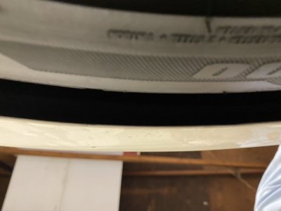

CARFAX does show a rear end accident but the only evidence I could find was that when you open the gas filler door, you could tell that the screws that attach the filler neck have been removed because some of the paint is missing on the screws. So yah, it looks like it probably had the left quarter panel replaced. Here are some pics, taken directly from below:

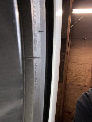

Sorry, the pics aren’t great. It’s hard to tell, but the first pic is the left side and the second is the right. You can see the difference in clearance. This is with the rear and perfectly centered.

Yes, that’s correct; it rubs on the left side, which is not rolled flat.

I agree, that's a repop quarter. It needs to be rolled. Find someone that has a roller. Awhile back there was one floating around on this forum, or another one, don't remember. You could borrow it for the cost of shipping.

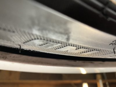

I went to get my lip rolled today. I found a place called Deity Motorsports here in the OC. He looked at my car and found evidence that the 1/4 panel had been replaced. He said they did a really nice job on it, so that’s god to know. He was concerned about rolling the lip because of the possibility that there may be some body filler that could crack in the process. So instead, he trimmed the lip and painted the exposed edge. He charged me $80, which I think was more than fair. Here’s a pic from below.

I’ve had the car 2 years. It looks like the general consensus is that I have a replacement rear quarter. The car looks great and tracks nice & straight so I’m not too worried about it. Most importantly, the tires don’t rub any more!
