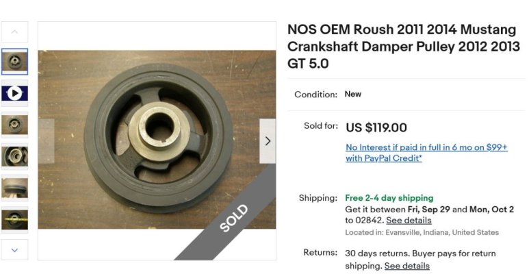

I'm finishing up major work (timing chains/MMR guides, followers, lifters, valve seals, phasers, new timing cover) on my car: 2010 Roush 'Hammer' 4.6L 3V. This was Roush's top-of-the-line specialty vehicle for that year. It has a 2.3L TVS supercharger on it, which is driven by a "spider pulley" setup that includes the damper and pulleys. The setup was used on '03-'04 Cobras and is somewhat odd and trouble-prone.
Anyway, I'm cleaning up the damper, getting ready to re-install it, when I see the elastomer bulges on front and rear. The damper is no good, glad I inspected it. I call Roush, but of course they don't stock any more, and nobody makes them. Then I call Brenspeed and a few other places. No help, they all wish me luck, haha. I figure I'll be very lucky if I can find a used one somewhere, or maybe some specialty shop that rebuilds existing dampers.
And then I figured it's time to shop on the old interweb, using the part number on the damper. I did a search and there was a page of returns, but only one mentioned a damper.
I was absolutely blown away, because it was the exact damper I needed, and it was cheap, and it was BRAND NEW! The automotive Gods smiled on me.
Sometimes you get lucky!

Youve done all that work and are running a stock balancer, why?
The damper is a truly rare item, it's a Cobra damper, it's anything but 'stock'.
Look at this picture below of the front of the one I bought and you'll understand. Are you suggesting there is an aftermarket replacement available?? If so, please post a link or something for me to search. Thanks

There is nobody that rebuilds them. Buy new. Sadly you will be switching brands.
Ahh, thanks, I didn't know about rebuild services. I bought that new one in the eBay pic. I was posting because I was AMAZED that I actually managed to find a new one. I never in a million years thought I'd find a brand new one. I thought I'd end up paying top dollar for some used POS damper........

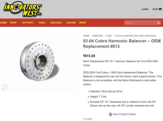

There are no aftermarket SFI rated dampners for '03-'04 Cobras? Fluidampr, ATI, etc.
JC SSP
Nov 8, 2022
2,370
1,426
FL
I can read…. innovators west 813 was the only one mentioned.
Enlighten me… what did I fail to read.
