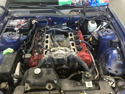

I've been waiting awhile to post this so forgive my excitement if I ramble. Im starting the rebuild on the 2006 Roush I picked up a few years ago. In 2002 I picked up a new GT Mustang, had it about 13yrs, nitrous, ProCharger, KB, forged, cammed, full exhaust, bla bla bla......besides the longblock rebuild and the tranny rebuild I did all the work installing the parts so I'm confident in my abilities with a wrench. I dont get into "lift, compression, duration, cam degree, etc"...I enjoy the building part of it. I did do the cam install on the 2002 GT but didnt degree the cams, just got lost in the literature lol! So far the 2006 is similar to my 2002 so Im finding my way around the engine pretty quickly
My car will be used for mainly pleasure weekend driving, probably wont see a track or road course unless I just go for fun, cruise nights. For whatever reason 650rwhp is what stuck in my head so Id say thats my power goals. I have no ideal if the setup I'm planning will get me that but I have no desire to go over that if its possible. Powers not reeeeally my deal but definately want to get the most outta what Ive got. In order to help you help me I'm gonna give full disclosure. What I have now is.....

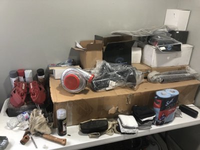

New On3 76mm turbo kit
New 2 On3 fuel pumps (plan to get another)
New DFC clutch
New On3 3 pump fuel hat
New PBR shock/struts
New cross drilled front back rotors
S550 used front calipers that I've painted
New SS brake lines......
........and $19,000!!!!
Currently in my MMR cart I have $5400 worth of motor parts, thats really the only place I know of. Im getting the rotating assembly, turbo cams, head studs, billet oil pump, gaskets, follower & lifters, springs, timing components, cam bolts,brisk plugs,crank bolt,....ask all the questions you want on this to make sure i have everything.
I'm going to have Lashbrook rebuild my tranny...$2200 im guessing. Doing a return fuel system so gonna need new fuel rails & regulator $600 and have to educate myself on doing the fittings for the lines. Im doing some sort of new front seats so $1000 on that. Buddy's shop is doing the tuning...FIC 1000 injectors and BA5000...$1000. Fuel and boost gauges $550. Wanting to do electric boost control so $1000 for EcoBoost controller and electric waste gate. Loved the MagnaFlow catback I had on my 2002 so looking at that $800
Just with whats up there I have $12550 worth of money already spent. Still have to pay to get shortblock built....so its going fast lol

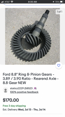

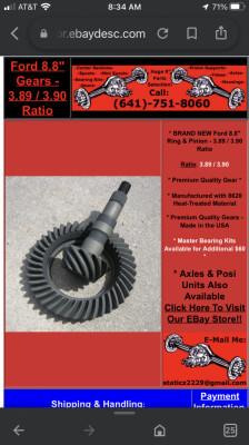

I’ve always ran 3.73 gears but thought about going to 3.90’s this time. Does FRPP make a 3.90 gear? Can’t seem to find any. Ran across this….good or bad?

Ordered the -6 forged piston/rod kit, timing chain kit, turbo cams, springs, follower/lifter kit, retainers, cam cap ARP bolts, brisk plugs, crank bolt, valve cover gaskets….$4600shipped
gonna start asking particular questions in separate posts, post pics as I make progress
