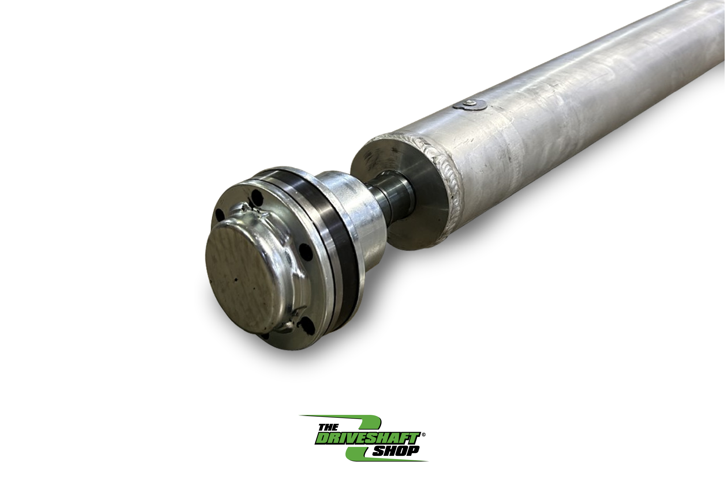

I've been running a Driveshaft Shop 3.5" aluminium driveshaft for the past 11 years and it's been great. Not cheap but definitely worth it, and the 19lb weight saving is also pretty useful. I could cruise at 100mph all day if it was legal.
this one? with the CV

you must add up all clearances from the ring gear, throughout the spider gears to the wheel. If I remember correctly you can move the driveshaft 10 degrees before the wheels start to spin when you go from left to right turning of it.
There is no noticeable play in the driveshaft u-joint or the two CVs.
