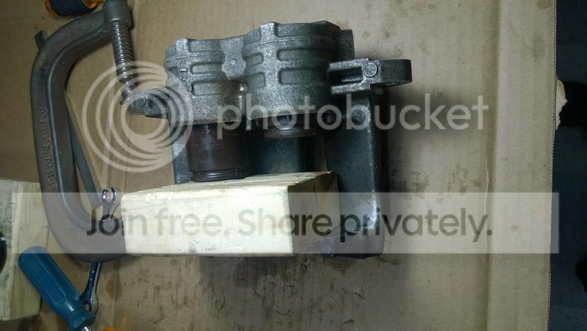

I had this issue about a year and a half ago where when I would come to a stop the front passenger side caliper would creak and loud. I could have the car shut off and press the brakes a few times to replicate it too. It did not change how the car would brake. It didn't pull to either side and even after fixing it I did not notice a change. I pulled the caliper off the car and attempted to service it. This was my problem before and I replaced the caliper and everything brake hardware wise on that side of the car in March of 2014. That piston would not move. Stuck like a son of a gun.

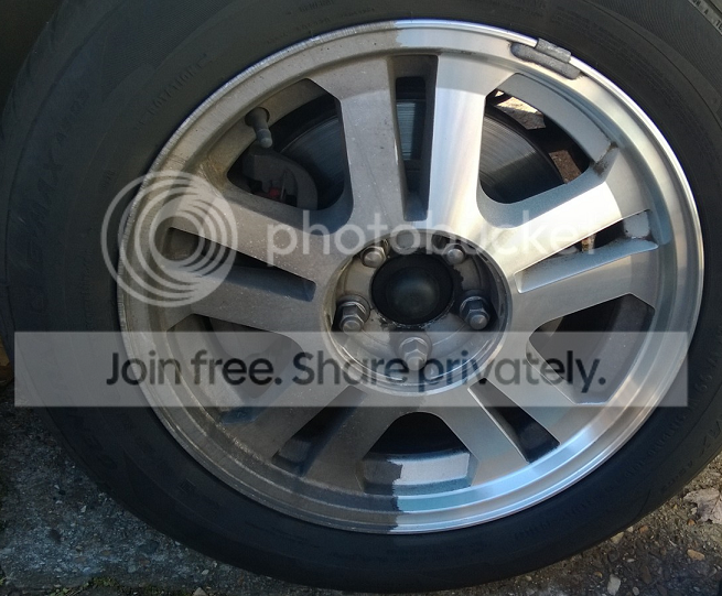

I do have a serious issue with these pads dusting. I contacted EBC before and they sent me a new set, after a bit of bickering, that dusted just as bad for 1k miles then stopped until a month ago and are dusting like crazy again. This is a week's worth of build up from the redstuff pads which EBC told me just tend to dust a lot.

There was when I took it off the car in March 2014. They were not damaged on that caliper. I have not removed the caliper on the car now to attempt a repair yet to know of the seal condition. This picture was for reference to the original time I replaced it. I still have new pistons, seals, and all new hardware to rebuild my current caliper when I get the chance.
