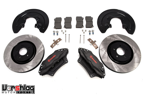

I have an extra 1500 left in my build. Would you guys buy the brembo front break kit and just put BMR springs on stock struts/springs. Or leave stock breaks and do koni yellow and springs? It's a street driven weekend car.
I may be biased but for $1499 you cannot beat the quality, performance or price of this StreetPro kit we sell.
http://www.vorshlag.com/product_info.php?cPath=141_142_179&products_id=559
If or when you start doing HPDE track events, then look at the brakes. If you don't already have the 14" Brembos then this is a good $1100 spent: link
