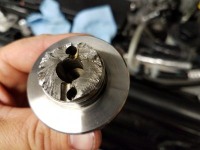

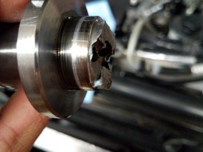

vehicle is a 2010 F150 5.4 3v RGR ported heads, custom grind Bullet cams,cam limiters installed with a blower. Ive had the driverside camshaft break twice. After the first one i sent both heads back to RGR he repaired the head and supplied another driverside cam. Reinstalled everything same passenger side cam, new driver side cam everything ran good for 12,000 miles broke the driver side cam again. Both cams broke under the front cam cap where the oiling holes are drilled. Has anyone had this issue before?

I’m thinking those custom ground cams have a problem with heat treatment if there is nothing wrong with the cam bore in the head.

The first broken camshaft bullet said had a defective core. Just find it odd that its happened twice on that side but the passenger side cam is fine.

I've got a set of Bullett cams that I bought used. The driver's side cam was replaced at some point by the original owner. I may be jumping to conclusions but maybe they have had a bad run of driver's side cores?
The way it broke, looks like it was not structurally sound around the oiling holes. Is it the angle of the picture or does the center of the cam look like the top side collapsed inward a bit?

I'd see what the manufacturer has to say about it. I wouldn't think that a camshaft would be brittle in that area. The location and the intersection of the oiling holes looks odd to my untrained eye as well.

That cam journal doesnt look good in the first pic. Looks like some galling happening there.
I dont like that it has happened 2x.

Don't like the way those oil holes are drilled offset to the internal holes, reduces cross sectional strength..
also sounds like to me, that either the spring pressures were too high or that the front springs were improperly shimmed, thus binding when the engine warms up.

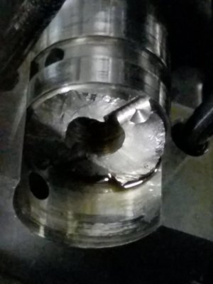

Repeated valve breakage concerns me. I have seen broken valves from a lean tune.
Oneslow50
Sep 28, 2020
20
It hasnt broken any valves. The bent valves were from when the cam broke pistone to valve contact.

The comp cams are drilled the sameway except not offset. In other words they line up with the cross drilled holes not halfway through the cross drilled holes.
