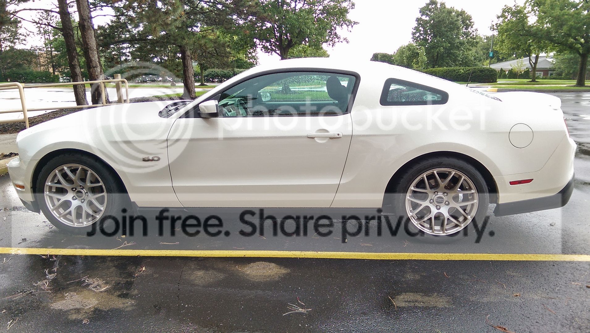

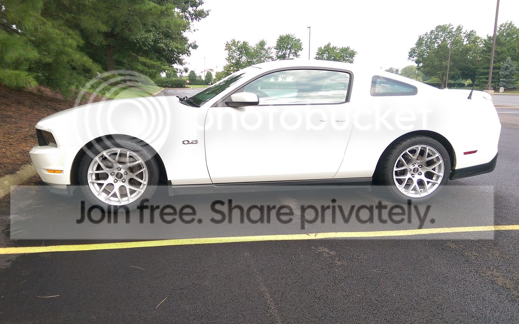

Update, got my new suspension installed. If you recall, I stupidly stripped all 8 strut tower bolts and so I needed to have the front strut/spring assembly removed anyways. So I decided to do a little upgrade while my local shop installed all new hardware on my Maximum Motorsports camber plates. I found a killer deal on GT500 front Bilsteins (same Vorshlag uses on their StreetPro kit) and I should basically break even once I sell my Eibach Pro-kit and the standard front Bilsteins. Now the front sits basically level with the rear, which looks a little odd to me. Since the rear springs are so much stiffer I set my rear Whiteline bar to full loose, which is still a little stiffer than stock. Initial impressions are... not much change in ride comfort. Haven't had a chance to track these yet, unfortunately - but I did get an additional .5 degrees of camber in front which should help. With the Eibachs I was maxed out at -2.35 and now I am maxed at 2.68. I had them dial in a little toe out and requested stock caster.
OLD: Eibach Pro-kit/standard Bilsteins
NEW: Maximum Motorsports/GT500 Bilsteins
