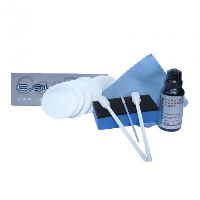

Is it similar to the blue piece in pic? That's a suede 4x4" mf towel. In the Dlux kit, they give you those cotton pads, similar to ones women use for make-up. I've found these work best for me when applying to smooth/textured trim. Its really hard to tell from the pick but my guess is the product was not applied evenly. Maybe you can hit it with Eraser again then try applying another light coat. The only issue I see though is it's cured and the additional coat may not wanna bond...

Yes it is similar. I think the color was a beige though. I don't have "Eraser". Is there anything else that will remove it? I have some 3M adhesive remover.

That I don't know, gonna have to talk to the guys I mentioned or check out Carproforum.com...
