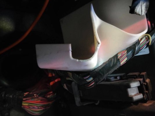

So when I got my 2005 in 2022 I found the floor on the passenger side to be damp. I cleaned out the cowl drains and remover the rubber snorkel from the bottom. I removed and sealed all the cowl clips. I also sealed the trim pieces that are above the windows. I thought that I had it sealed up good but after a few days of heavy rain I found that under my floor mat on the passenger side was again wet. I just took it for a drive and was shocked to see water droplets on the carpet coming out from the passenger kick panel.

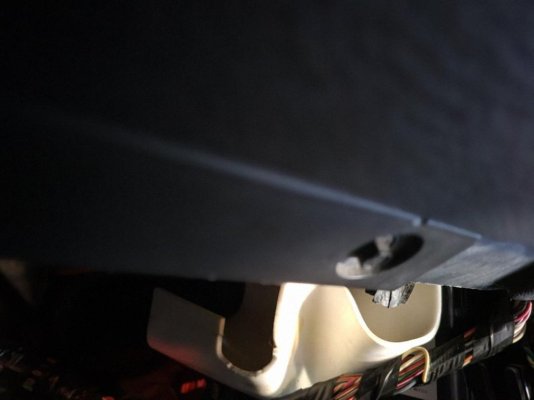

I removed the panel and found this white piece that cannot be factory but looks to be there to keep water from entering the SJB. It looks like it works as there was still some water in it that would spill out forward when you hit the brakes. Is it from the factory?

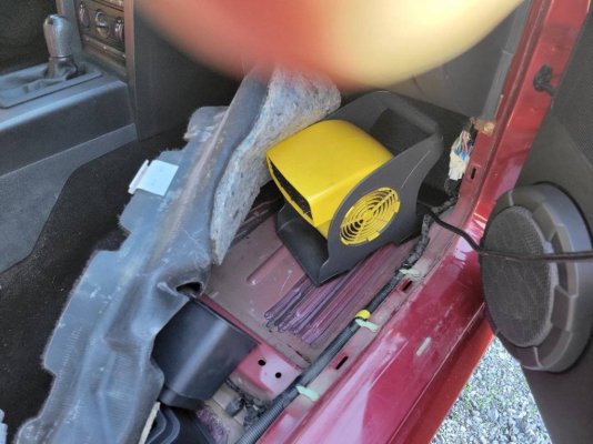

I removed the seat and have a fan going to dry the matt. I pulled the passenger side windshield cowl and all looks well there. No debris at all where the cabin filter is and it is bone dry. The clips are all still sealed. Now that the seat is removed I will be able to get in there and watch to see where water is coming in hopefully when the wife hits it with a hose. Very frustrating!!!

So I did some searching and have seen that white piece on other SJBs so it appears it is factory although none were shaped like mine is. I do remember reading that there is a gromet under the inner fender that can leak or the grommet from the door wires although that one I can see and it looks solid. If I can't find this leak it is a deal breaker as the car sits outside unfortunately.
Any ideas what might be letting water in that area? I'm sure once I locate it it will be very apparent, but again beyond frustrating!wd2.jpg

Is that white piece a soft foam sheet? Mines had a sheet from when it was new that sits between the SJB and the panel cover, which I always assumed was to stop rattling
Yes it is a foam piece. I don't think the way it is formed in the picture is the way it originally came from Ford. The water must be coming in directly above it as it was pooled in the foam and would run out forward when the brakes were applied.

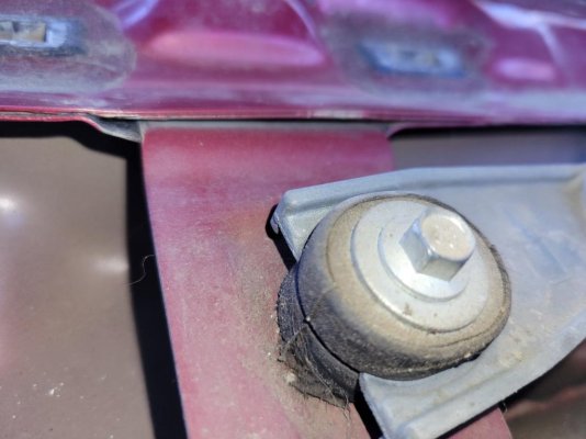

In the TSB it says that a cowl water issue will leak down right above the SJB. It is definitely leaking above the SJB since there was water in that white foam that is formed into a bowl.
The TSB also says to inspect the pinch weld in front of the cowl clips especially the center support area. I did and this is what I found.leak.jpg

Looks like they skipped this area all together with seam sealant. It is slanted down and away from the cowl but when driving in the rain water could be forced up there I suppose.

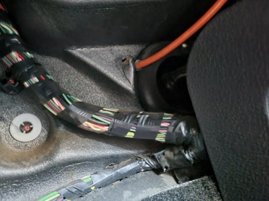

So after the unreal amount of rain we have had lately my carpet is again wet. I am going to pull the seat again and get the fan under the carpet to dry it out. I did notice this orange tube. That is the grommet that is under the glove box on the firewall. It is directly above where the carpet is getting wet. It doesn't look factory. Could this be my leak? Does anyone recognize this from their car?

Looks like from what I found that is a factory part so that's not the leak. I just pulled the seat and the insulation under the carpet is soaked in front of the seat and under the seat. The insulation that that is that is on the vertical panel where the passengers feet would rest is soaked. Beyond frustrated with this. None of the carpet feels wet so it seems the water is getting in under the carpet.
