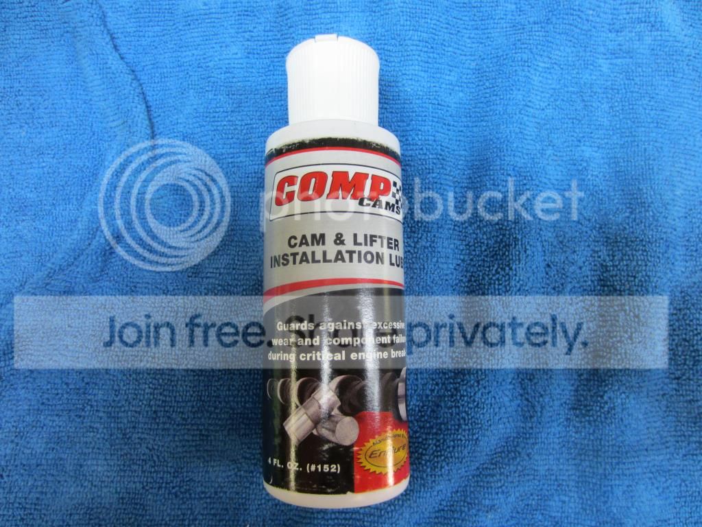

I'm no expert but I'd use assembly lube on new cams. Reassembling used cams I would just use oil. I may be wrong but in my mind the assembly lube may help with a little extra protection during the initial break in (first 10-20 revolutions).

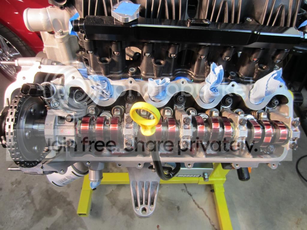

The reason for the question is I watched the Ford tech video and they say to just put oil on the cams and the journals. Today I asked a question on the FRPP site and the tech guy said don't forget to use assembly lube?????
