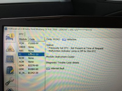

i had the samething happen to my 06 gt,
i replaced fp,fps fpdm . started rite up ran great,took it for a drive was ok for 3 years then it started acting lick it had bad fp again. so i did all stuff again this time it didnt start run for more than 5 min sometime week. long story short it need a computer see pic.
check your tps, kinda act the same it will drop out sig run really weird.then be okIMG_0012.JPG
